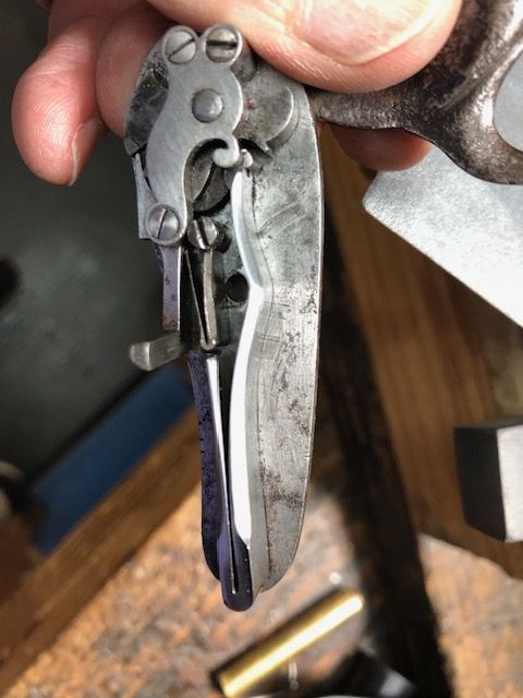

James Flynn sent along some photos of a unique spring he built:
[Linked Image from i.ibb.co]
His exact quote, which, seems deliciously understated to me:
Probably the strangest spring I ever made. It was for a French dueller which explains the Gallic eccentricity.

Very nice, Mr. Flynn. I see the near perfect gap between the leaves. Of course that is what I would expect from the man who produces perfect leather covered recoil pads.

I remember an article about the springs on a Rigby double rifle back when Rigby had moved to California for a time, I know they’re back in England now, anyway the gap between the leaves, and the radius of the cut at the end of the leaves was a great discussion.
That’s a beautiful spring, nice job

I replaced the spring because it was broken. Guess where the spring broke.
The bend in the middle of the spring is to clear the lock bolt. I have made many springs in my day but this was the oddest.

Who was the lock maker, James?

Stanton, as you can see, there is no name on the inside of the lock plate. I do not remember the name on the outside. It was not a best quality pair but they will still shoot.

I noticed that, James. I've had some pretty rough looking locks on m/l(s) that still worked well and had good trigger pulls.
