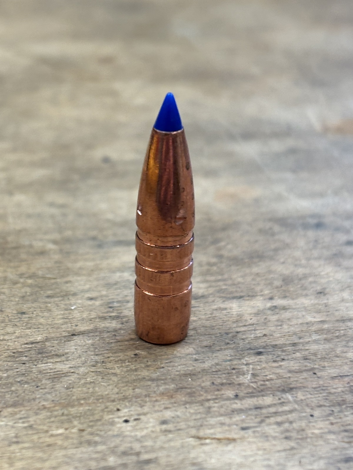

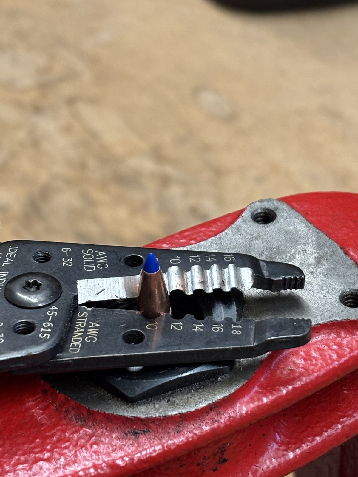

I really appreciate all the input on this. In the interest of not buying another tool I tried Kutter's suggestion, and it worked well. I needed to pull only 4 out of the box of 20 I was working on. The marks on the bullets were minimal as long as I held the electrician's plier tightly so the bullet did not slip in the plier. I've attached a couple of photos showing the pliers I used and one of the pulled bullets. I also found, advertised on the internet, this puller that works on the same principle: https://grip-n-pull.com/

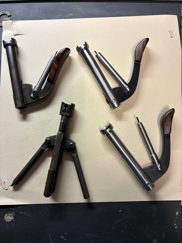

Using anything that strikes a primer can detonate it as strikes are made to set off primers. But slowly depriming without any strike will never set off a live primer. I've used my Pope style re-decapping tool made by Jerry Cleave for me to do thousands of live primers and never had any issues. A regular press mounted die allso deprimes without setting off live primers, but a lot slower than my Cleave tool is.

Not to pick nits but, to pick nits, being a retired electrician/electrical contractor after 45 years in the trade. Those are wire strippers, not 'electrician's pliers'.

A selection of cappers/decappers.
