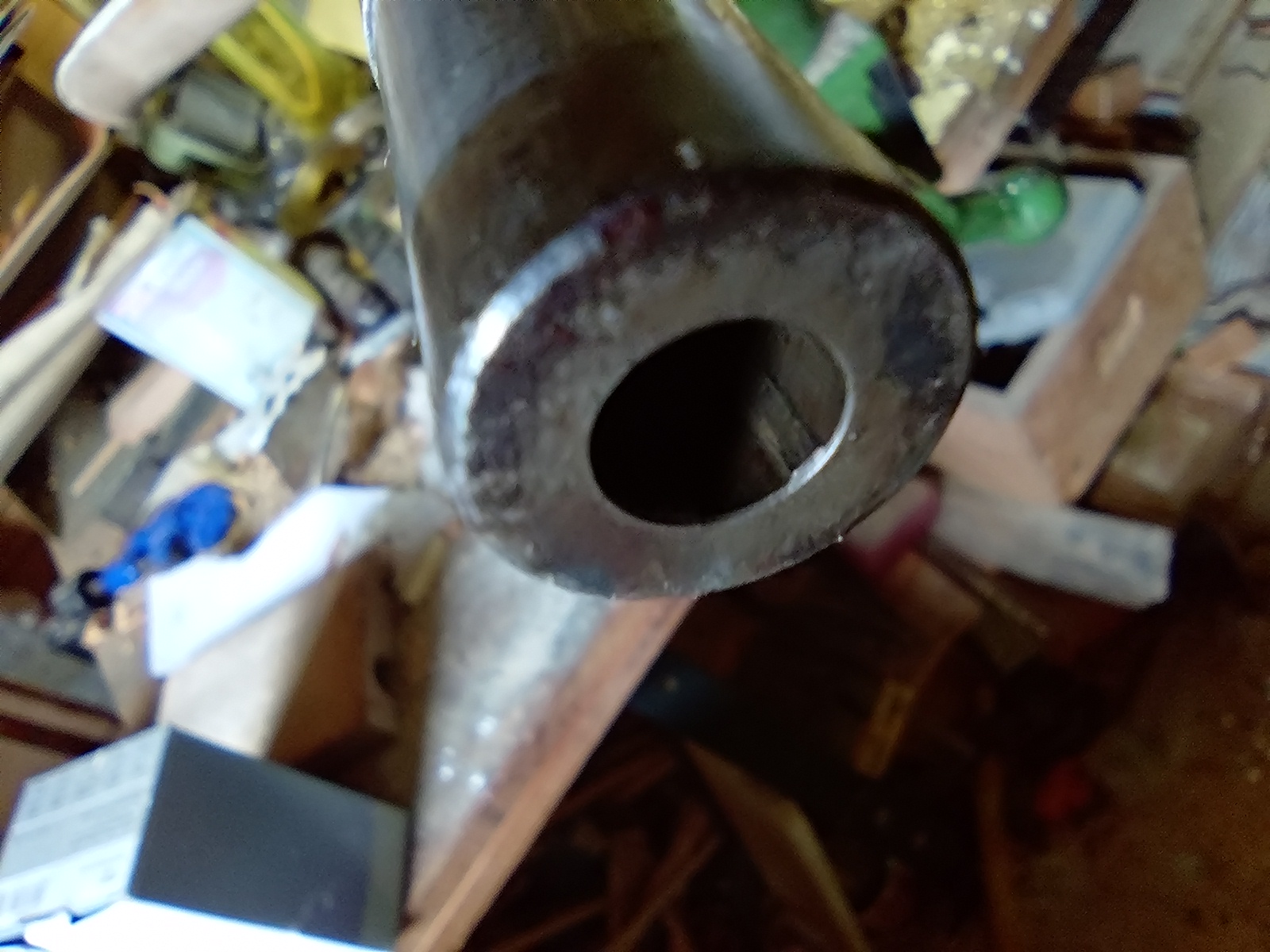

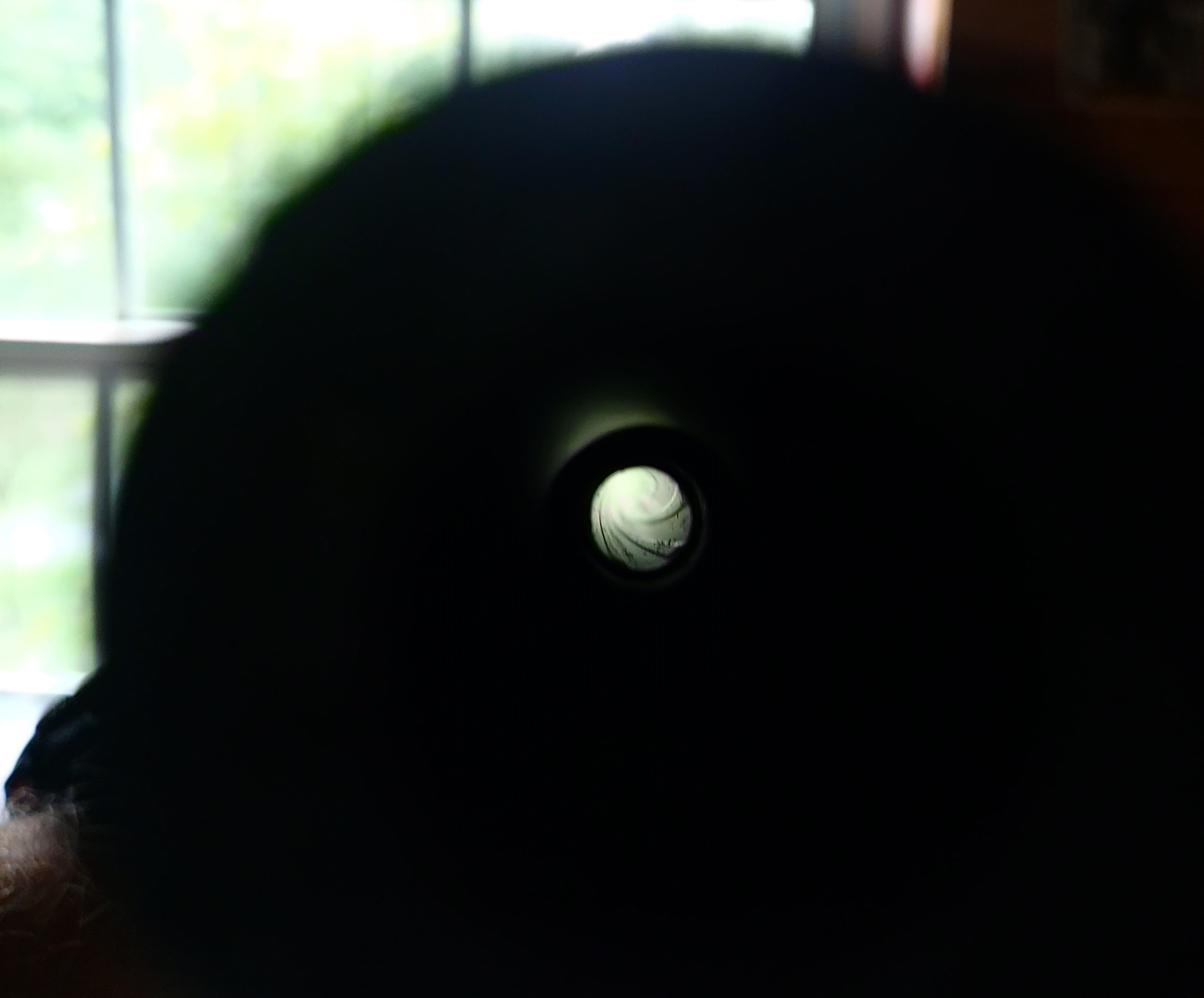

Ryan, which way is the twist and how many grooves? I have pictures of a Pope barreled bolt gun that I took at the Colorado Collector show for Tom Rowe. Tom would be a good source to reach out to for information. He has wrote a few books on Pope guns and is in process if one on Jersey City rifles. He is including in this book guns/barrels that were not known before this book and not made in Jersey City.
Bob
Thanks Bob. I got an email from a former member saying a new Pope book was in the works - I look forward to it. I bought the Ray Smith book. "Sincerely HM Pope" is really expensive. Is Tom Rowe on this forum?

I have a number of Pope barrels on '03 Springfields that were for jacketed bullets and they are all right hand twist while his single shot lead bullet rifles are left hand twist. They all have Pope's markings on the bottom of the barrel, an example is:
650
WL
HT
14/0
3/5/24
H M Pope
My take on the caliber marking is the barrel was originally something like 30-06 and when it was rechambered, they added this caliber marking. None of my jacketed bullet Pope barrels have a caliber marking on them.

I agree, that makes sense. The barrel was probably rechambered and the caliber so noted.

Pope did indeed make barrels for bolt action rifles, and also for pistols. The marking on your barrel is likely from his later years in the Colgate Building in Jersey City, NJ. The two numbers under the forearm are not what you see on earlier barrels, but his earlier barrels were also left hand twist. I'd guess one of those is Pope's barel number, and likely it's the higher of those two. His later barrels were also done as right hand twist, so not unusual to find a RH twist Pope barrel in later years.
This is a really great find, and better than almost any other named maker's barrels. Well worthy of a nice Mauser action to fit it to. I have 5 Pope barreled rifles, and one Remington Model 1891 target pistol Pope barreled and modified for Olympic shooting. Top pistol in this picture. Bottom is an Arthur Hubalek built version:

Had a great conversation with Tom Rowe who is about to publish his two volume set of books on Pope. Turns out this is barrel 622, made as a 30-06 for a Mauser. He had a record of 621 and 623 which were also 30-06's for Mausers, but 622 was missing - now found. How cool is that.
I asked him about the barrel steel used at that time and he said "Soft". What do others have in the way of input on shooting their Pope barrels? Do you use jacketed bullets in your 03's? Do you avoid shooting them at all? Do you shoot them frequently?
