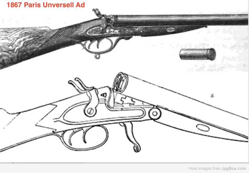

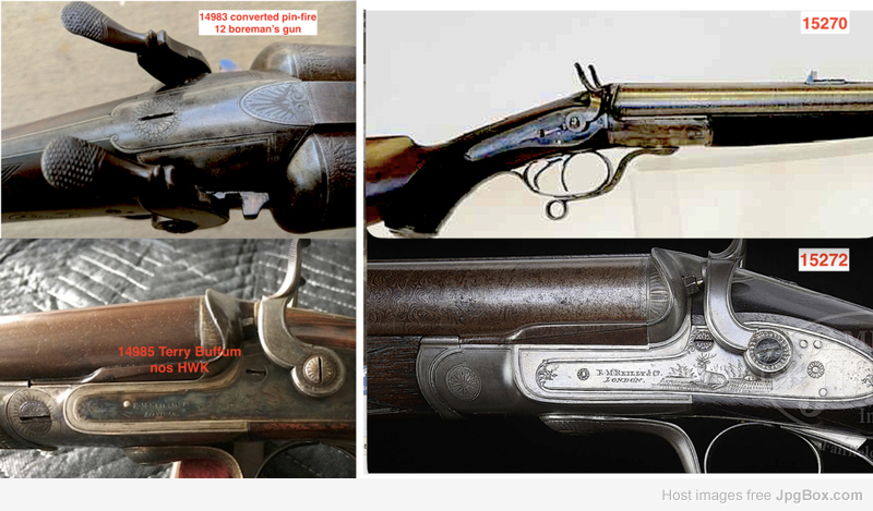

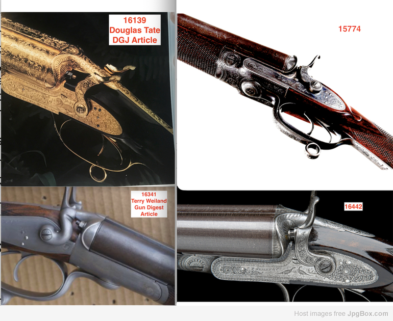

It has non-rebounding hammers – normal for this time period. The first Reilly with original rebounding hammers is 15126 from 1868. However, many guns were still being built with non-rebounding hammers and pin-fires continued to be popular up to as late as 1872.
The hammers have very short noses on them. Reilly centerfires early on used noseless hammers as advertised in the 1867 Paris Universelle Fair and although Reilly also used conventional nose guns, noseless hammers seem to be very popular from 1867-1870. Here are a few:
