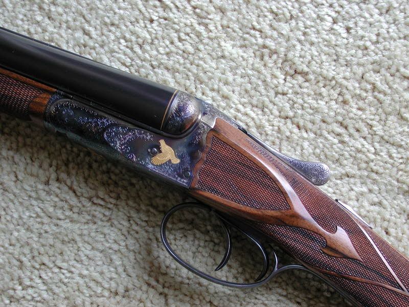

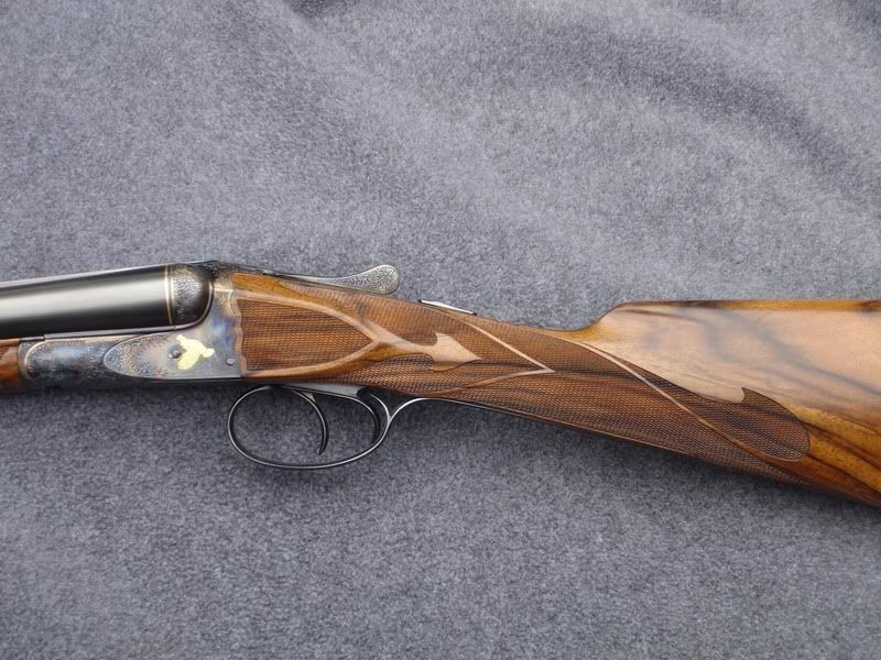

OK JOe here's some pitchers. Checkering cradle, some hand tools that I use, some Fox photos and a Daly pic. I do have an electric buzz saw (Doiron) but it really isn't a beginning checkerer's tool IMHO.
Doug Mann
