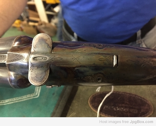

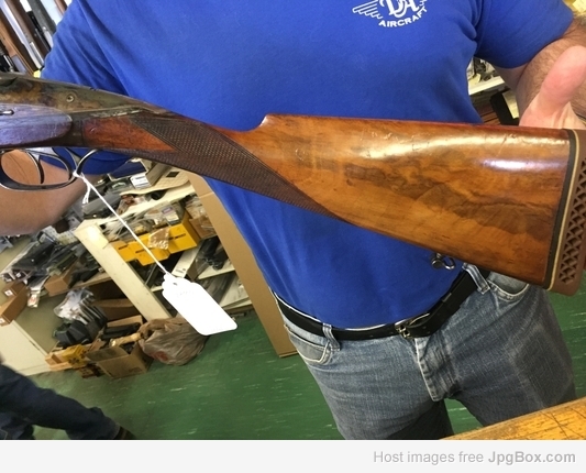

Posted By: Ghostrider Looking for information on Darne 24 gauge - 11/17/17 07:47 PM
Hoping to learn something about Darne shotgun. How rare is a 24 gauge. It is marked Halifax on the top pull levers. I am assuming this is the model.
Stock has not been cut and is still curved but a pad is installed. With the pad removed it will have a little over 14” LOP. Where might I find a buttplate?
Very nice wood but pretty plain engraving.

Posted By: GLS Re: Looking for information on Darne 24 gauge - 11/17/17 09:40 PM
24 gauge is more common in Europe than it is in the US. It is scarce to rare in the US. I'd love to have one. Gil
P.S. call Larry at http://www.dutchmanwoodworks.com/ for a buttplate.
When talking Darne guns, 24 was rare in Europe, too. I asked Hervé Bruchet, 20 years ago, if they still built 24 gauge guns, and he answered, "Yea, but, I don't know why. Nobody buys them. I don't know why they would".
And so it goes. You have not lucked into a winning lottery ticket, just the lowest grade Darne R model gun, with brazed barrels instead of monoblock barrels, in a gauge that is hard to feed. Not impossible, mind you, but, you will have to really want to shoot it, in order to do so. Most of the 24 gauge Darnes I have seen were 2 1/2" chamber guns, as well. The barrel flats will be marked 6.5 or 65 if that is the case.
There was, at one time, a specific "Halifax" buttplate. Older guns often had horn that had lines cut in it (my Halifax is so equipped). The Dutchman buttplate is a reproduction of the typical R model buttplate, and would be perfectly usable, in addition to being made of stable ureathane, instead of the organic horsey hoof plastic the original was, which, is not stable, and tends to shrink and/or crack.
The screws would have been lightly engraved, with a thin slot (NOT phillips head) and skillfully aligned up and down.
Pictures would be good, especially a clear one of the flats of the barrels. You can email them to me, and I will post them here for all to enjoy or to be scornful of.

Ted a few pictures sent more to follow tomorrow.
Got a few:
We have a Halifax with a conventional R model safety, decent wood and case colors, and a SWEEEEEET white line pad of some sort. I'm not positive why one needs a pad on a 24 gauge, but, someone did it.

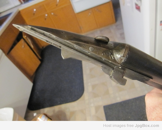

Ted, GR..trying to figure out some of the markings. 65mm chambers..so post 1912; Just under the proof marks on the barrel flats are crossed muskets and I have sort of subliminally associated these with Belgian made barrels for some reason. Assume the 17314 is the barrel maker's serial number. There is no SN for the gun posted that I can see - otherwise we could try to date it using Gil's posted chart. Curiosity killed the cat I know.
My Halifax 16 gauge SN 49505 has the SN marked at least 4 places, at least that is all I have found. #1 is on the barrels; #2 is on the metal piece attached to the stock just forward of were it steps down to enter the forend portion. Can only be seen with the barrels removed. #3 is inside the trigger guard & #4 is on the lower "Wings" of the opening lever.
Barrels are 68 CM (just shy of 27"), wt is 5lbs 14 oz, bores are marked 17mm so was proofed @ .669" a slight over bore for nominal .662" diameter for a 16. Chambers are marked 65, though they have been lengthened to 2 3/4 inchs with a long forcing cone. Check on wall thickness revealed "Plenty" of meat there. It carries the French double proof with PT smokeless powder. Marked on frame License Darne & #4. I have the original horn buttplate but it was badly moth eaten. I wanted to see if I could fill in the holes with some epoxy with black coloring added but haven't got it done yet, would need some touching up of the lettering etc as well after filling. It is currently wearing a butt plate from a Browning "Double Automatic".
Essentially I like everything about this gun except the safety. I have tried reversing it & found that even worse to me, don't like operating a safety with my trigger finger. Wish Darne could have figured out how to put a thumb push safety on the top somehow, but just doesn't seem compatible with the sliding breech action.
Stock has a very, very slight rounded semi-pistol grip. It really doesn't change the handling that much from a straight grip, but I think a straight is more aesthetically pleasing, just my opinion of course. Nothing fancy or a highly desirable collector, just a very good shooter. As far as shells I have not babied it & it has stood everything I have fed it without a hitch, including some low velocity 1 1/4 oz loads.

Argo,
17314 is the serial number of the gun, and appears in several places on the gun, if I am not mistaken. The "crossed muskets" are not, in fact, crossed muskets, or, Belgian, but the crossed lightning bolts of the St Etienne proof house applied to guns that have been proofed in a finished (completed) state.
Yes that is the SN. Shot it for the first time today. Action is a little tight but I think will loosen up a bit after shooting a few more times. The safety also works as most do. Fliping the lever forward and its ready to shoot. Pull back and its on safe. Weighs 5 1/2 lbs. looking forward to shooting some dove soon.
It takes a LOOOOONG time to break in a Darne. But, when it happens, especially on an R model, it is a beautiful thing.
Enjoy the gun, and have a great Holiday Season.
