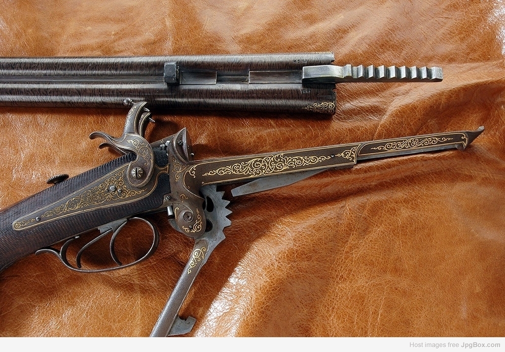

Hi Guys. I have been playing with this J. Wangler dual ignition pinfire & centerfire 14 gauge. It was made in the early 1870's. I call it the "Bear Trap Gun" because of the teeth that protrude into the trigger guard. A special thanks to Bill Bates for the outstanding photos. Enjoy! [img:left]http://www.jpgbox.com/page/51142/[/img]
[img:left]http://www.jpgbox.com/page/51150/[/img] [img:left]http://www.jpgbox.com/page/51151/[/img] [img:left]http://www.jpgbox.com/page/51152/[/img] [img:left]http://www.jpgbox.com/page/51153/[/img] [img:left]http://www.jpgbox.com/page/51144/[/img]

What a contraption. Could you provide an image of the Belgian marks on the underside of the tubeset? Moose Snoot & I have been chasing Puškar Jan Wangler v. Jenikove(Golcuv Jenikov) on ShotgunWorld and I believe Moose Snoot ferreted out the patent for the 22 part scattergun mousetrap?

Reminds me a bit more of an alligator / cocodrilo?

What a piece of wood. Jani, what is the proper name of the stock/grip?

I know that gun...I took the photos for a good friend. It is always interesting to see where my photos show up.
Here are a few more/

Any chance there is a image to see what the port in the butt-plate accommodates?

Do I understand correctly that the dual ignition system works like this ?
When using it in a pinfire mode, the pins in the hammer noses must be retracted or removed.
When in the centerfire mode, the pins in the hammer noses are extended to block the pinfire pin openings in the barrel breech when the hammer is fired.

ellenbr, sorry I just looked through my files and I didn't have any photo with the trap all the way open. I will be seeing the owner in a couple of hours so I will ask him what is in the trap.
Here are the last two images which I had not uploaded before.
