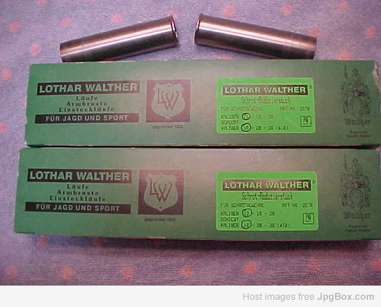

Why do all that?
I used Lothar Walther adapters to convert a Remington 3200 barrel set
to 16 gauge
Using a set of these
https://www.gunbroker.com/item/952494023

Do the extractors/ejectors still work with the Lothar Walther inserts?
Posts: 5,444
Likes: 146
Posts: 5,444
Likes: 146
I cut a slot in the inserts,
welded up some 12 gauge extractors,
and refitted them to 16 gauge.
All now work as a normal 16 gauge
