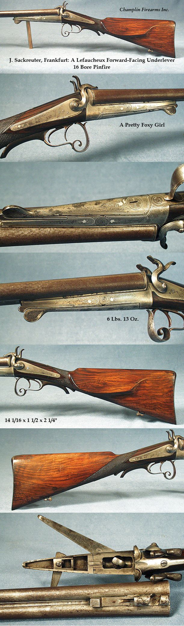

This was a very common method of finishing. It is most often seen on Germanic guns. Apparently it did not appeal to Americans then. Instead of sulfuric acid, they used hydrochloric to achieve that deep etching. Today, most refinishers use ferric chloride. Early Persian makers used a form of Nitric acid.
Here is an early example from Champlin Arms.
