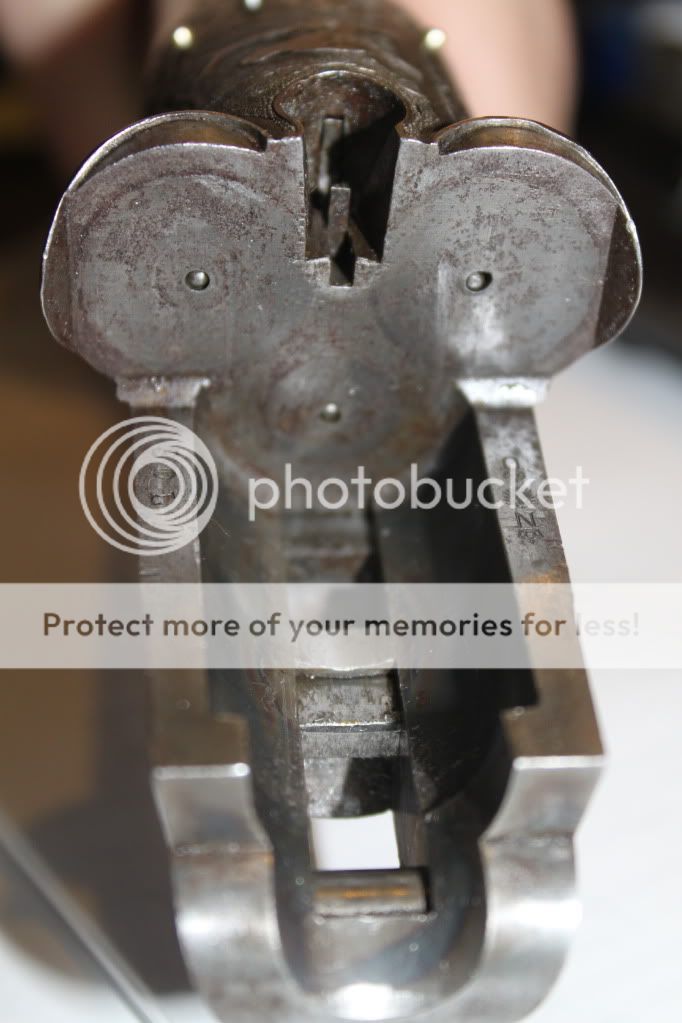

Another update - chamber information. (this keeps getting weirder)
So the current theory is that the cartridge is approximately .300 / 8mm based on the proof marks. It was also marked either 58 or 68 under that proof making some believe that was the cartridge's length. 68mm = 1.72", 58mm=1.473". Neither really match up to the information I've received from the measurements taken with a dial caliper.
Based on measurements of the chamber:
The cartridge's rim is .500"
The base of the cartidge after the rim is about .434" wide.
5/8" into the chamber, the cartridge is about .415" wide.
At 2.3" into the chamber, there is a constriction that is either a really tiny shoulder or it is the lams, I can't tell.
The bore at muzzle is measuring .316 to .325 depending how I measure but this is a fuzzy number.
What kind of cartridge existed in 1911 that was rimmed, about 2.3" long (or longer) and had a tapered description such as this? Upon further review there is no taper/shoulder or reduced neck on this cartridge at all. It is a straight walled cartridge that gradually tapers down to the bore size. I've yet to find a metric cartridge that was built like this during that period of history.

Lebeda is the only name I can think of right off but I don't know of a C. Lebeda. Also it has a Bavarian or Austrian style cheekpiece.
Note the side of the scattergun tubes have the post September, 1911 "Eagle Nitro" stamp. Evidently they were applying the "Nitro" stamp a bit earlier and still using the plug gauge post 1910.
Interesting device in the dolls head well. Just pour some wax in it and make a cast. I'd 1st compare it to he 8x58 Sauer but the cast will narrow the field.

RookHawk, most probably 30L means 30Left - some part from left side of the box and it might be the same shape part from the right. Pair parts of English guns marked R and L in this case.

Incidentally, I looked at the 2nd word with a 10x jeweler's loop and it definitely says "C. LEBxxxx". The third word's letter preceding the MBERG could be an A but there is only 5% of the letter remaining.
