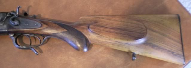

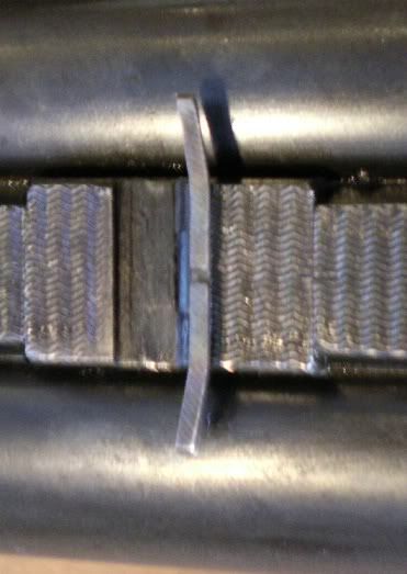

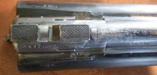

Raimey,
Thank you for your response, here are some pictures of the gun.
[img]http://i278.photobucket.com/albums/kk86/olypenn222/drilling/dr3.jpg[/img]
[img]http://i278.photobucket.com/albums/kk86/olypenn222/drilling/dr2.jpg[/img]

Originally Posted By: olypenn22
Can you tell me what the initials are on the underside of the left scattergun tube at the end of the "Krupp Fluss Stahl" stamp, or maybe a "Crown" over "S"? Looks like a set of initials right under the "8.7mm" stamp on the rifled tube just about the Gothic "J" which I think noted the Jaeger craftsman. The rifled tube may have experienced the preliminary proof more than once as the "Crown" over "G" is either pretty low or beside a worn "Eagle". The tube may have been modified to accept the normalized 9.3X72R or maybe it was proofed separate prior to 1912 and then again under the 1912 rules. The Drillinge is a No. 8 and described as follows:
"8. Hammerguns with three barrels, Roux action, double bars and forwarded rib, best rebounding locks, insertion for ball by lever on the disk, visor to lay, on simple stock, plaine line engraving."
The marks date from 1912-1923 but if I'm not mistaken, I think the 9.3X72R was normalized circa 1914. So it would have been made between 1914 & 1923. Many times an example finished in F.W. Kessler's shop will have the FWK monogram on the standing breech.

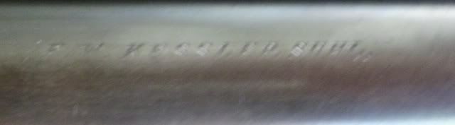

Raimey,
Thank you again,
"Can you tell me what the initials are on the underside of the left scattergun tube at the end of the "Krupp Fluss Stahl" stamp" looks like ESSV,
The rest of the stamps are as you discribe, the FWK monogram is on the breech, receiver and barrels.

Then the stamp would be Krupp Fluss Stahl Essen or Krupp Fluid Steel Essen. A guess would be that on a good day the Förster Dreiläufer would realize between $1200 - $1500 U.S. of A. and possibly a bit more to a hardcore F.W. Kessler collector. Someone, and it may be me, was putting some info together on ole F.W. Kessler and it I might find it if you are interested. If there are any initials or letters on the back side of the locks(if you every have them off) like a "S&S" or "N" or near the forend lug, I'd be interested. Could you supply a pic of the FWK monograms? The Förster Dreiläufer is very similar to the Sauer Model 19(XIX) less the 1/2 pipe side frame reinforcement and I would guess that components were sourced from Sauer. I'm sure you well know, but the top lever selects the the ball(kugel) or shot(schrot) and the right trigger should push forward for the single set trigger or German stecher.
