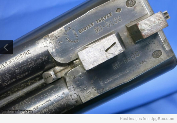

7 cm chamber: Another Didier-Drevet barrel - previously posted by Raimey; Can't see the date but it's an "Acier Mandrine" (I think Mandrine means "machined" or "rolled" on a mandrel - a central chuck; see the 1900 barrel with the same "Acier Mandrine") SN looks like 12537?? (1908 per SN progression). 18.4 and it's chambered for 7 cm. (Made for a Darne??). If you can match up the gun SN with the barrel date, you might have a ball park idea of when that particular gun were made.

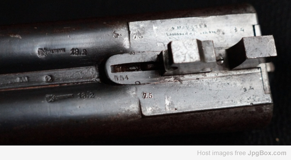

7.5 cm chamber: And this is interesting: An 1890-1912(?) 18.2 guage G.Peyron hammer gun chambered for 7.5 cm. Barrels by Marsot. "Double verrou,levier à volute" à platines "en avant" dont on trouve déjà des modèles dans des catalogues de 1884,mais il doit en exister de plus anciens car le "Levier à volute" existait déja sur des Lefaucheux à broche.

Argo, I'm a little suspicious about those 7.5's. Virtually nothing else nearly as clearly legible. Makes me wonder whether they might have been lengthened later on--perhaps by someone clever enough to know that on a gun of that vintage, they needed to use 7.5 rather than 75.

I don't know Larry; it's a fascinating looking under-lever with apparently Damascus barrels though they look steel in the photo. Here is the comment about the chambering:
Concernant le chambrage il est vrai que les fusils de cette époque étaient chambrés à 65 mm toutefois certains modèles dit "à chambre longue" existaient, et si je te parle de çà c'est que le double marquages "7.5" m'interpelle car je me demande s'il ne s'agit pas de la longueur de chambre en cm.
As for the chambering, it's true that long arms from this era were chambered for 65mm although certain models called "long chamber" existed. If I speak of this, it's because of the double mark "7.5" especially since I'm wondering whether this might not refer to the length of the chamber in cm.
