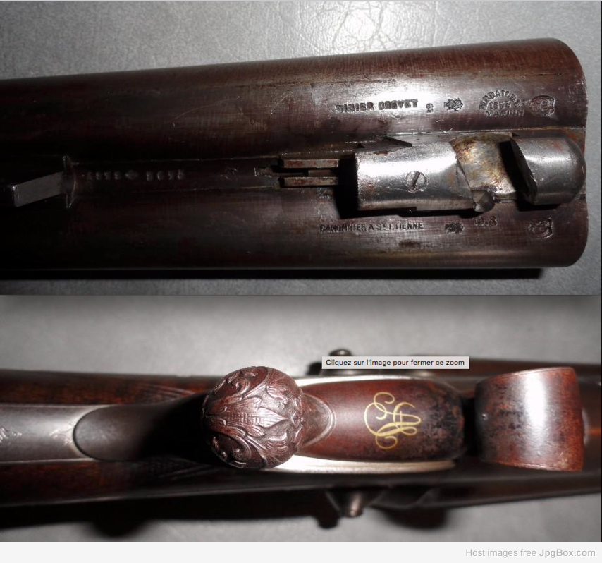

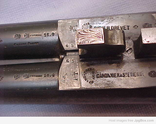

Ted in a separate line asked how I could date a Saint-Etienne 16 gauge accurately. I've chosen to start a new line to keep from "jumping the shark" on that one.
I’ve been looking for a early 20th century Saint-Etienne fusil de chasse for some time. French guns are very difficult to date we all agree. Using the usual markers (prizes won, models, catalogs, patents, etc) might get us into the ball park. But there are two items that will definitely narrow down an earl 20th century period piece:
...1) use of cm to denote chambering would mean it was pre-1912? (it would be interesting to find out the exact date this changed from cm to mm): and
...2) Didier-Drevet barrels are dated and have a serial number.
I wonder if there are more examples of dated Stephanois guns? For background (and it's been discussed before ) here are a few dated Didier-Drevet barrels from the internet (reorganized chronologically): -- (images back thanks to jpgbox)

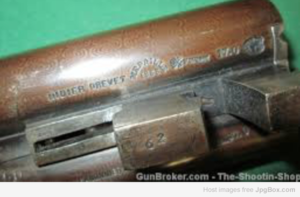

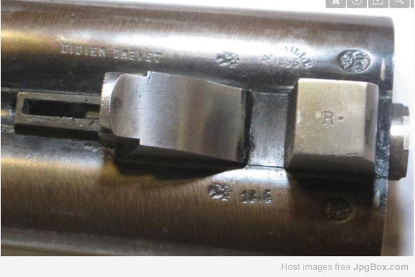

1). 1878 Didier-Drevet fusil (damascus) date on the gun (not the barrel). 65m Chambers.
http://www.tircollection.com/t18880-un-beau-fusil-de-chasse-sobre-et-elegant

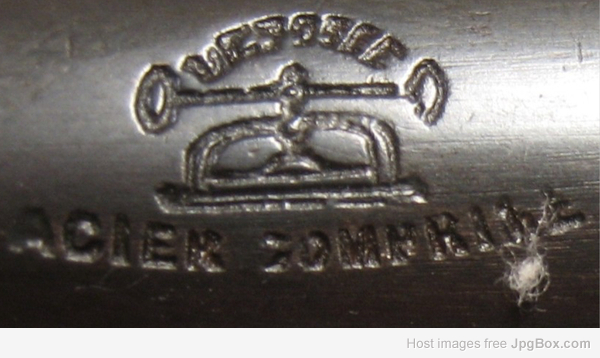

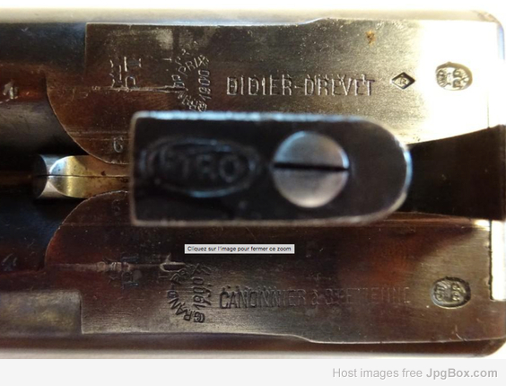

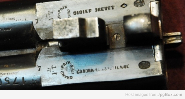

2). 1900 12 gauge:

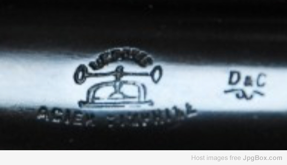

Didier-Drevet Acier Mandrine (Mandrel Steel) (Mandrine means "turned on a mandrel or lathe"; un Mandrin is a Mandrel; Mandrine is an adjective modifying the feminine noun Acier) Canon Plume barrels; 18.4; 6.5; 1900 - 8971
http://www.doublegunshop.com/forums/ubbthreads.php?ubb=showflat&Number=396092&page=all
3) 1904 from a Russian site:
Didier-Drevet Eureka Canon Plume barrels; 18.4; 6.5; 1904 - 11046
http://img.allzip.org/g/1/orig/15625032.jpg
4) 1905 Cyrillic site:
Didier-Drevet Eureka Canon Plume: 1905 - 11604 (unclear)
http://arc.violity.com/ruzhe-didier-drevet-1900-g-12132152

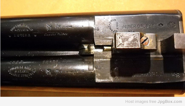

5) 1906 16 gauge with 7cm chambers: The is Ed Good’s gun previously posted. I discussed this with Ed and he assured me a chamber gauge showed them to be 2 3/4”. I told him it had to have been rechambered. Then noticed this little “7” on the barrel flats (7cm). It does indeed seem to be a 1906 with 2 3/4” chambers.
Photo deleted: Didier-Drevet Eureka Canon Plume barrels Stamped 17.0; 7; 1906 - 11985

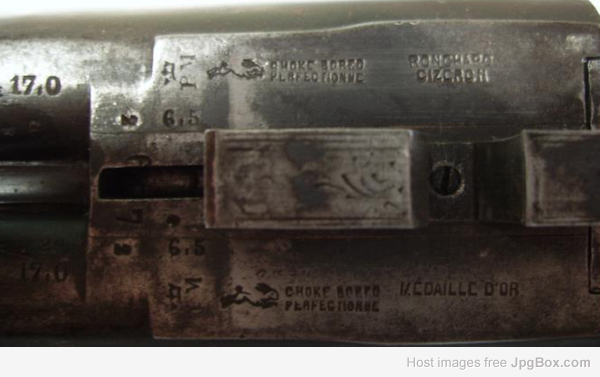

6) 1906 Didier-Drevet 12 bore from 1906 with 7cm chambers:
Didier-Drevet Eureka Canon Plume barrels; 18.4; 7; 1906 - 12076
7). 1908 Per able2zero, Shotgunworld:
Didier-Drevet Eureka Canon Plume barrels: 17.0; 6.5; 1908 - 12740
http://www.shotgunworld.com/bbs/viewtopic.php?f=5&t=223806
8). 1910 12 gauge with chambers labeled 6.5. The seller advertised the gun as having 2 3/4” chambers. I asked him about this - he claimed “6.5” had nothing to with 65mm and the chambers were as advertised. If so, it’s been relieved:
(photo deleted - Didier-Drevet Eureka Canon Plume barrels labeled 18.4; 6.5; 1910 - 13185

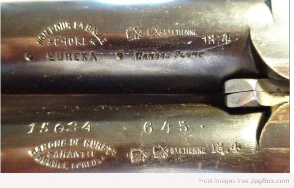

9). 1918 Didier-Drevet - Skeetz's gun:
Didier-Drevet Eureka Canon Plume barrels; 18.4; 65; 1918 - 14204
There must be some additional info someplace: The French magazine “Armes de Chasse” issue nr 42, Juillet - aot - septembre 2011 had an article under Collection titled Le trio Didier-Drevet.

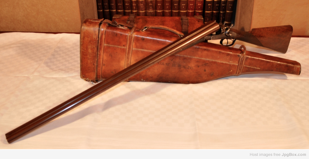

Picture number 6 is a gun I am very familiar with, as it lives in my neighborhood, and I posted a bit about this gun here on the board. It is the wreakage of a high grade Darne that doesn't fit the description of R, V, or P model. The picture you posted is missing the proof stamp, which, was for powder J. 1900 was the year powder T was introduced, but, for at least a few years after that, one could specify powder M, J, S, or T. Hence, we can't even state with authority when a gun was built based on the powder it was proofed with, save the fact that anything proofed with powder T would be post 1900. Further confusing what and when with this gun, is the fact that Regis Darne's offerings were pretty well sorted by 1900, and this gun doesn't appear to be a cataloged model, or, marked with a stamp in reference to grade.
Documenting an exact time of change for the markings 6.5 and 65 could be problematic as well. The proof house in St. Etienne is a literal hive of activity, and the day I was there, there were rack upon rack of modern pump and autoloading barrels being proofed for Verney Carron, among all the other barrels. It would seem to me that the 6.5 mark could have very well been used alongside the 65 mark until it simply wore out and was discarded.They mean the exact same thing. Again, documentation would be wonderful, but, we simply don't have that, yet, and anything else is speculation until we do.

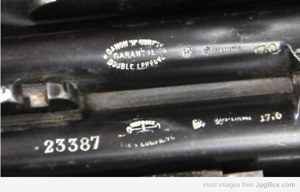

12 gauge both with 65mm chambers
2292 number but no date
19468 number but no date

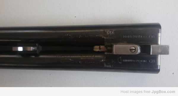

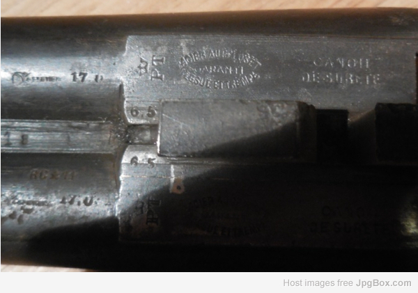

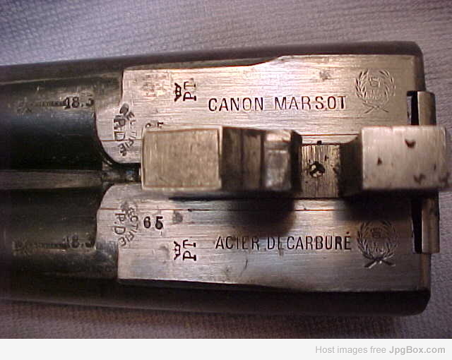

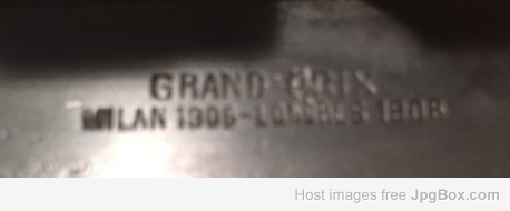

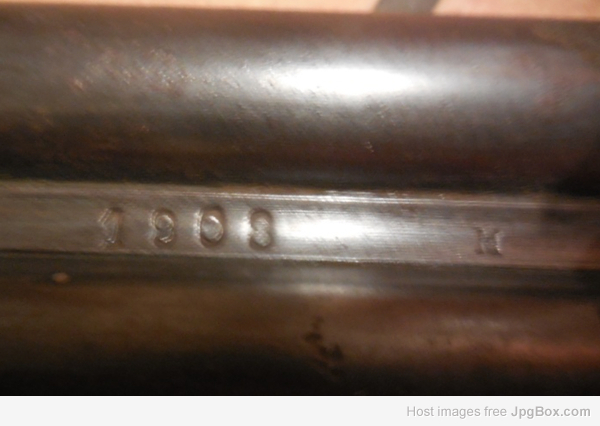

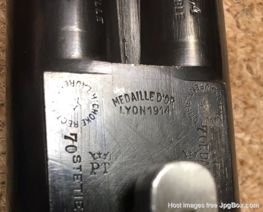

I've been playing a similar version of this game for thirty years. You can come close, but, I question ever being able to nail a precise date down.
This would appear to be the oldest gun I've got, at the moment:
Note that the gun has the 6.5 chamber stamps. Proofed with powder T, for sure later than 1900. I once owned a Darne V20 that was identified as 1910 by the maker. It had 65mm stamps. It was also serial numbered in the 52,000 range, illustrative of a few things. Production was roaring on Darne guns in that era. I've seen few Darne guns of that age with Didier barrels, and I suspect the Darne factory simply out grew their suppliers fairly early on. You will see many old Darne guns with the stamp "Canons Darne" telling you that Darne produced their own tubes. At what point they made that leap I am not positive, but, I suspect prior to 1910. The V20 was clearly marked that way.
Herv Bruchet dated the V20 by comparing the work of the engraver who signed the gun, "Bernaud", with earlier, known examples of his work and a bit of history. Bernaud had to work into his mid 90s, and the later his work was, the worse it got. This was evident on my example.
But, it is the exception in my experience, rather than the rule, that one can nail down a date. No, we can't be sure who stockpiled barrels for French shotguns at the turn of the previous century, producer or manufacturer or, for how long.
The Halifax barrel flats, shown above, are from a pretty old gun. A friend has a Halifax 4, this being a Halifax 3, and the engraving is identicle, which points to his being a later gun, as does his five digit serial number, as opposed to the four digit number on this gun. A call to the factory got him a date of early 1930s, which, seems about right when considering the catalog evidence.
I suppose I'd guess the example Halifax in the photo as between 1905 and 1915. It is an educated guess, but, no more than a guess.
I can't clearly see a way to narrow it down beyond that.

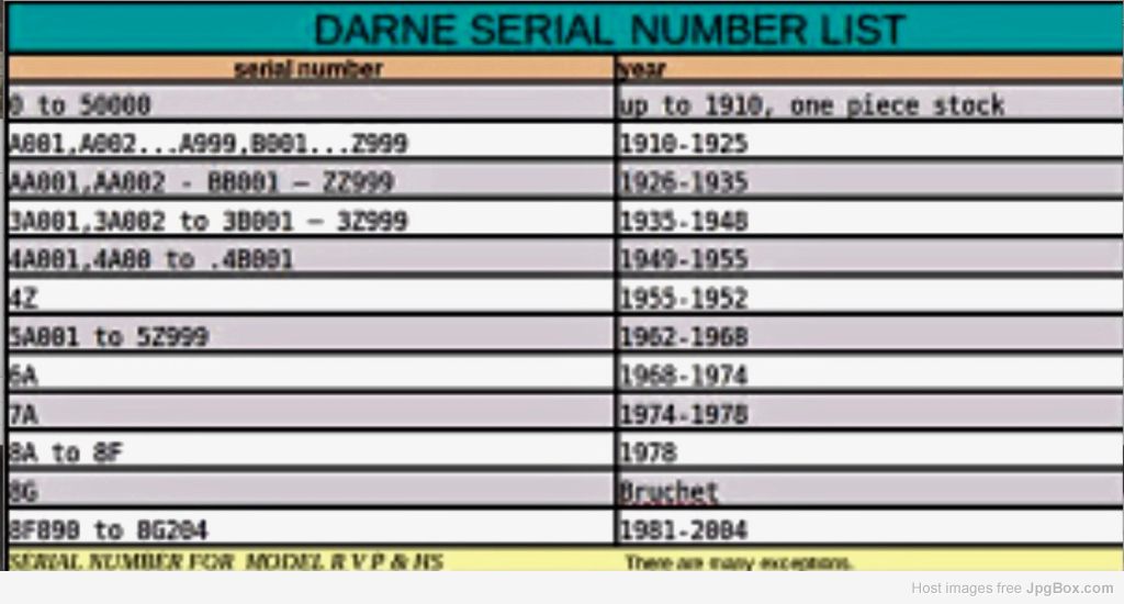

Probably best to remember that with those French ladies, don't think only about dating them. Think about taking them home for a longer term relationship. smile
Posts: 9,446
Likes: 512
Posts: 9,446
Likes: 512
At least when we are speaking of Darne products, you aren't holding up your end of the bargain, Mr. Brown...

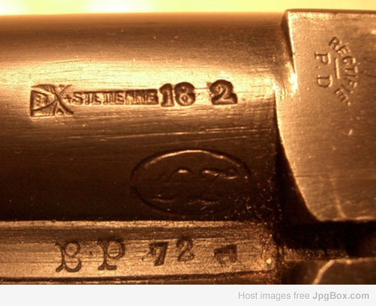

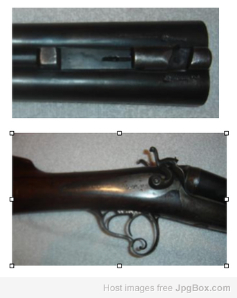

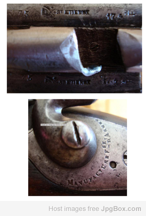

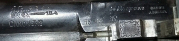

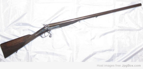

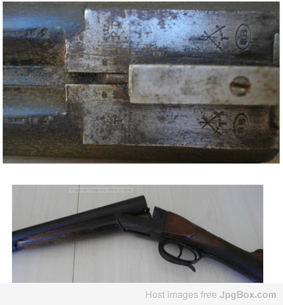

7 cm chamber: Another Didier-Drevet barrel - previously posted by Raimey; Can't see the date but it's an "Acier Mandrine" (I think Mandrine means "machined" or "rolled" on a mandrel - a central chuck; see the 1900 barrel with the same "Acier Mandrine") SN looks like 12537?? (1908 per SN progression). 18.4 and it's chambered for 7 cm. (Made for a Darne??). If you can match up the gun SN with the barrel date, you might have a ball park idea of when that particular gun were made.

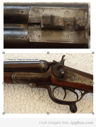

7.5 cm chamber: And this is interesting: An 1890-1912(?) 18.2 guage G.Peyron hammer gun chambered for 7.5 cm. Barrels by Marsot. "Double verrou,levier volute" platines "en avant" dont on trouve dj des modles dans des catalogues de 1884,mais il doit en exister de plus anciens car le "Levier volute" existait dja sur des Lefaucheux broche.
Le Levier volute ne doit pas tre confondu avec un systme voisin la "Cl Beringer" ou "Pontet-Serpent" .
Les premiers commandent une fermeture dite "en "T"" ou "T anglais" ("Tea time's" ?) Very Happy ;mais par la suite ils seront comme le tien adapt un double verrou classique.
Pour donner un point de comparaison permettant de le dater; la "ManuF" propos des modles strictement identiques au tien de 1890 1900 avec des canons Damas
Je n'ai pas russi trouver s'il y avait eu aprs 1900 des modles canons acier comme ce fut le cas pour les modles platines "en arrire" jusqu'en 1912 .
Il faut toutefois noter que les modles "en avant" comme le tien valaient en 1893 20% de plus que les modles "en arrire" canonerie gale.
Mais le "Levier volute" pu aussi bien tre abandonn pour les modles les plus chers, et rserv aux modles "conomiques" vu la diffusion aprs 1900 de la cl "Top Lever" que nous utilisons encore.
http://www.tircollection.com/t22742-fusil-de-chasse-g-peyron

Argo, I'm a little suspicious about those 7.5's. Virtually nothing else nearly as clearly legible. Makes me wonder whether they might have been lengthened later on--perhaps by someone clever enough to know that on a gun of that vintage, they needed to use 7.5 rather than 75.

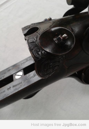

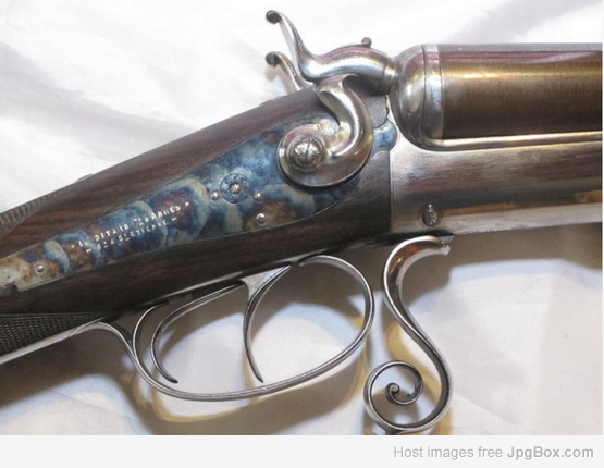

I don't know Larry; it's a fascinating looking under-lever with apparently Damascus barrels though they look steel in the photo. Here is the comment about the chambering:
Concernant le chambrage il est vrai que les fusils de cette poque taient chambrs 65 mm toutefois certains modles dit " chambre longue" existaient, et si je te parle de c'est que le double marquages "7.5" m'interpelle car je me demande s'il ne s'agit pas de la longueur de chambre en cm.
As for the chambering, it's true that long arms from this era were chambered for 65mm although certain models called "long chamber" existed. If I speak of this, it's because of the double mark "7.5" especially since I'm wondering whether this might not refer to the length of the chamber in cm.
And by the way, the poster uses three words for types of underlevers:
-- levier volute
-- Lefaucheux cl
-- Cl Beringer" or "Pontet-Serpent

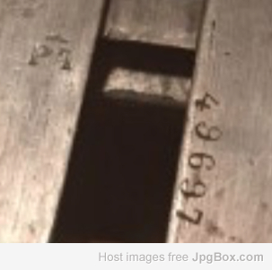

Mike, I just realized your "19468" is not the SN for the DD barrels. The DD barrel SN is 1918 - 14204 per comment above. That 19468 must refer to something else; perhaps the SN of the gun itself?
Posts: 5,444
Likes: 146
Posts: 5,444
Likes: 146
YES, and I just looked again and there is that second set of numbers smile
1918 . 14202

As I mentioned above. I wonder if this was one of the first shotguns made after Nov 11, 1918. I think the whole Saint-Etienne industry concentrated on the war effort and not on making sporting guns. This is mentioned in an article about the Berthon Bros patents. Is that other number the serial number of your gun? Is there a name on your gun? If so, you've come pretty close to dating it.

And this I've added to the Didier-Drevet date database and the serial number dating matrix:
1885: 17.0; 1885 - 4911 - hammer gun, underlever Damascus barrels on a PONDEVAUX ET JUSSY gun (photos kaput thanks to greedy photo bucket) -raimey and WC - if you have photos of the barrel flats saved someplace, it would be an education to see them again.
http://www.doublegunshop.com/forums/ubbthreads.php?ubb=showflat&Number=406682&page=4
With the 10 examples above, we can now pretty well date every serial number barrel made by DD! 10 points on a graph over 33 years is pretty darned definitive (even if we don't know the exact start date of his manufacture - it must be before 1855 because he won a prize) - and by dating the barrels and matching them to the guns they're mated with...we'll have a firm marker on the dates the guns themselves were made? And since we have that marker on a date that brand of gun were made - it could be carried over to a whole series for the brand. Not bad - not definitive but better than nothing. I need to make a graph.

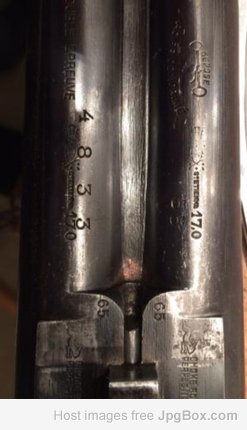

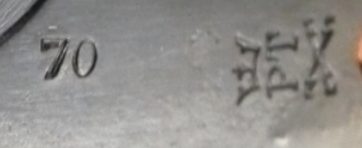

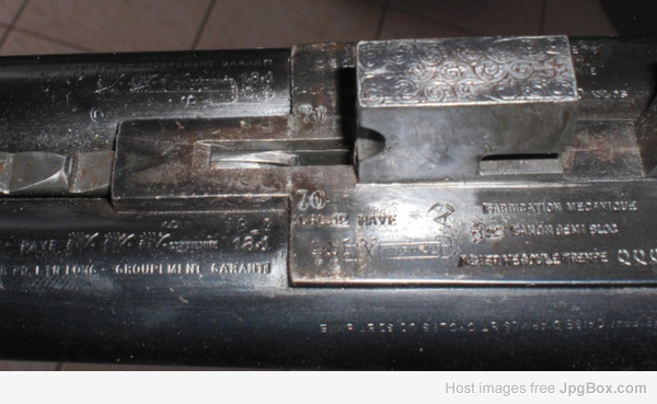

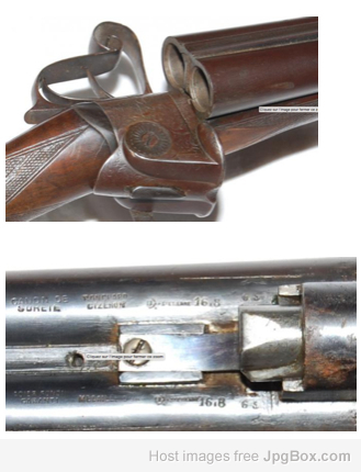

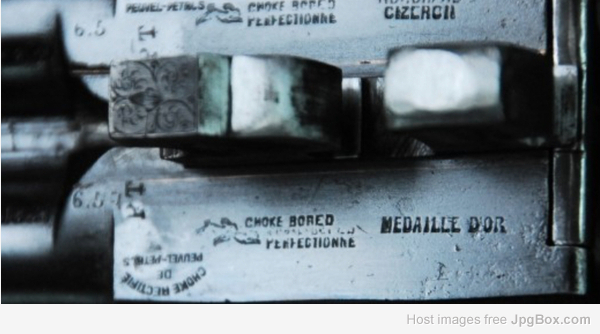

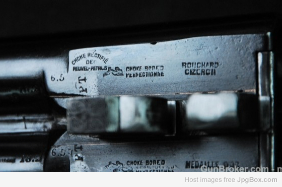

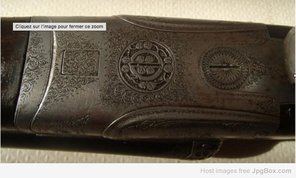

I'm going to post four Saint-Etienne Barrel flats from 1900 to 1938. Two reasons: 1) Didier-Drevet may not have been the only one dating his barrels at this time; and 2) 70 mm (7.0 cm) seem to have been more common than assumed:
1). 1900, 6.5 chambered in cm; 17.0; Barrels by Ronchard Cizeron showing the proof stamp of St-Etienne in use from 1868-1900. Probably made at the end of the 19th Century and proofed for nitro powder. Expert option (see link) is that it was made, assembled or marketed by a gun dealer in Rouen.
http://www.littlegun.info/arme%20francaise/artisans%20p%20q%20r/a%20ronchard%20cizeron%20fr.htm
2). 1908 (?)(date?) (no SN); 17.0; 6.5; No name; Saint-Etienne.
http://www.passionmilitaria.com/t78322-fusil-de-chasse-a-identifier

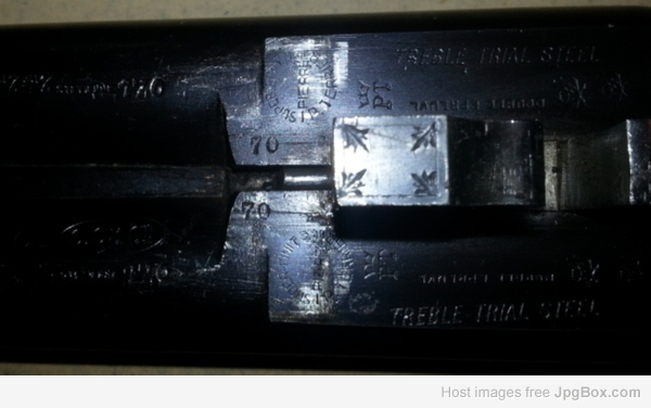

3). 1939-45; 18.4; 70 chambered in MM. Neltir believes it is C.G an Cie from Sociee Franaise de cycles. The name was registered 2 Feb 1916 and lasted to 1947. This gun used either Heutier or Belgian barrels
Bonsoir , je crois savoir que le marquage C.G & cie mane de la socit franaise de cycles fonde par Clment et Gladiator spcialise dans les armes de guerre et de chasse au Pr St Germain en Seine St Denis ,76 grande Rue . Cette marque a t dpose en 1916 le 2 fvrier et active jusqu'aprs 1947 . Ils utilisaient soit des canons heurtier soit des canons Belges en acier spcial Treble trial Stell import d'Autriche je crois me rappeler .Ces canons Belges taient exports par la fabrique Belge "The Liege United Arms C LTD depuis 1923 et nomme par la suite en 1946 FAL et puis F:A:U:L pour fabrique d'armes de liege et fabrique d'armes unie de Liege qui prs prouvaient les canons destins a l'export .Cette pratique tait utilise dans la priode sombre des annes 1939/45 et aprs suite l'occupation car la France manquait de produits armuriers .
Neltir .
http://www.passionlachasse.com/t15623p15-trouvaille-de-vieux-fusils

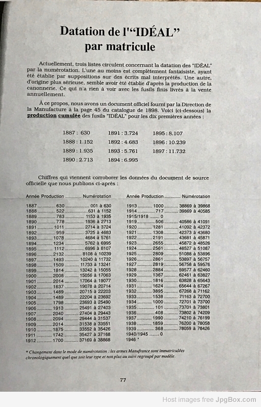

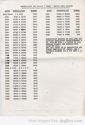

4). 1928 Ideal, chambered for 70 mm.
Trs bel IDEAL , il est de 1928 et normalement chambr en 12/65 , jecteurs automatiques , canon droit ray "supra" pour le tir balle et le tir dispersant plomb .
Le n 9EE/S est propos la vente en 1930 au prix de 4600 fr . A l'poque , a reprsente une somme !!
http://www.tircollection.com/t18237-et-j-ai-vu-aussi-ceci#239972

Another dated w/SN Didier Drevet barrel in an unnamed Saint-Etienne gun with SN and chambered for 7 cm (2 3/4). The numbers stamped on these barrels (see the various ones above) not/not associated with a date - in this case "17502" - are the SN's of the gun itself stamped on the barrels by the gun maker. I've confirmed this several times. - Neat looking gun!! (And if you don't know where is "Avranches". take a look at the Normandy campaign breakout)
1). 1907 - 12613?; 18.4; 7 chambered in cm; Gun SN is 17502 (No idea what this means); No name; marketed (or assembled) by Geneaux of Avranches (Normandy):
http://www.gunbroker.com/item/667146081
And this date graph continues to expand (see page 1); if gun owners with DD dated barrels can supply gun maker names and gun maker SN's...soon we'll have a decent idea of French gun dates in the first 20 years of the 20th century.
I'll try to do this graph...starting with dates....adding proof marks, powder marks...using the SN's from the DD barrels..and then separate graphs for each manufacturer who used those barrels. I can do the analysis (and Ted, WC, Raimey, Larry et.al. have the knowledge) - But you all have the data.
And what's with all the 7.0 chambers? I have one a 1906 with a butt plate stamped "model expresse". Can I shoot modern 2 3/4" ammo?

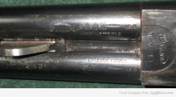

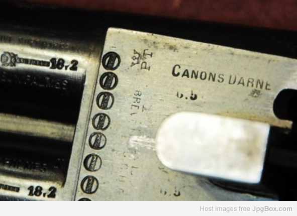

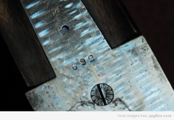

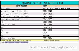

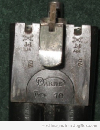

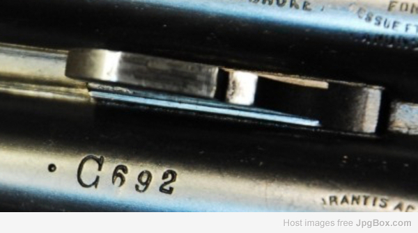

I've been trying to match dated pre WWI Didier Brevet barrels with makers' serial numbers without much success. Here are three Darnes"
1). A Darne from second paragraph first page with DD barrels dated 1900 chambered for 6.5 cm (pre circa 1912). No Darne gun SN is mentioned in Ted's original post about the barrels.
2). A Darne type 18 12 guage with Darne made barrels SN C692 on the barrels and 692 on the gun and chambered for 6.5 cm (pre c1912)
http://www.gunbroker.com/item/670294785
3) a Darne type 10 20 gauge with Darne made barrels SN C643 on a gun with the number 643 and chambered for 70 mm (post c1912).
http://www.gunbroker.com/item/671021768
I guess as far as Darnes go, there is no matching up the SN's. Did they have SN's?
Posts: 9,446
Likes: 512
Posts: 9,446
Likes: 512
Argo,

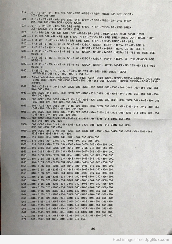

The serial number of the Darne wreakage, with the 1900 date stamp, if that is a date stamp, in my above post is 759. I did make mention of that in the post.
Darne serial numbers make sense to whatever regime was running the company at the time the gun was built. All Darnes have a serial number, and, as far as I know, all clones do as well. We are discussing a company that has been in business for near 150 years, and in a country that has come out victorious in two world wars, after suffering under a scorched earth policy during same.
While it is possible to date a Darne by it's serial number, there are so many exceptions and running changes that one needs to be in contact with someone knowledgable at the factory to be able to do that. Example: It is impossible to accurately date ANY Darne with an SPC or SPL prefix-this referred to a custom order gun, and the serial numbers were not broken out by date of order. When Paul Bruchet was alive, it was very possible he would recall building a higher grade V model so marked, but, that was a long shot, as well. Further, even using the list that was posted on Geoffroy's website until it went dark some time ago, you only got close with a serial number-the combination of letters and numbers only identified a decade, not a year.
That list, incidentally, only applies to guns sold in Europe-anything could be and was imported to the states, which, was considered a secondary market.
Good luck in your quest. I believe it will be quite daunting.

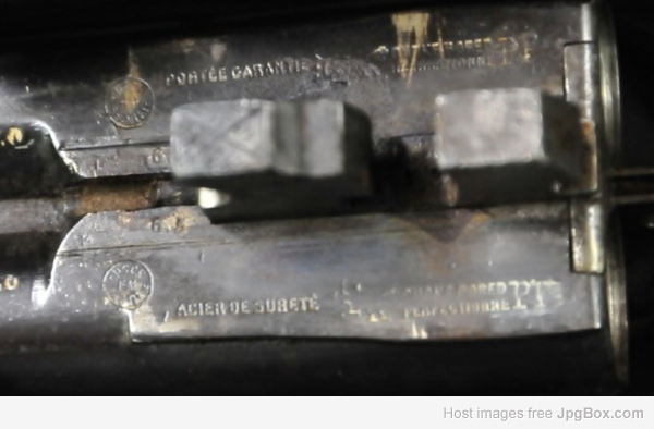

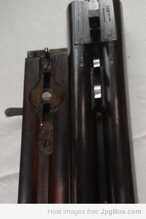

Here are three more Didier Brevet dated barrels and with these, there are definitely date markers.
1). 1903 - ????? 18.4; chamber? (ad says 65mm but no pic - assume it is 6.5cm); Buffard Armurier SN 5397. (no pics of the action or barrel flats - only the description)
http://www.naturabuy.fr/Juxtapose-Buffard-item-4014832.html
2). 1912 13689? 18.4; 65 chambered in mm; Note the 1912 shift to mm.
http://www.naturabuy.fr/Fusil-Juxtapose-St-Etienne-cal-12-70-Didier-DREVET-item-3577295.html
3): no date - 15035; 18.4; 65? Chambered in mm; note the lack of a date;
http://www.naturabuy.fr/Magnifique-rare-Didier-fusil-grand-prix-1900-canon-plume-item-3949391.html
With this we're pretty close to nailing down
-- the date of the change-over in Saint-Etienne from cm to mm,
-- the date of the first barrels made by DD following WWI, and
-- the end of DD punching dates on their barrels.
I'll post a proto-graph separately which will be based on these datapoints compiled on page 1 - repeated here.
1852 - DD begins to serial number and date his barrels
1855 - Gold Medal for Barrels - Exposition Universelle des produits de l'Agriculture, de l'Industrie et des Beaux-Arts de Paris 1855
1878 - ...????; 65mm chambered in mm; 18.6; Gun Maker: Didier Fusil; Sn: ?? (damas underlever hammergun)
1885 - ..4922; ??? chambered in mm; 17.0. Gun Maker: ??; gun sn: ?? (from page 3)
1900 - ..8975; 6.5 chambered in cm; 18.4; Gun maker: Darne; gun sn??
1903 - ,,?????; chamber 6.5??; 18.4; Buford Armurier SN 5397
1904 - 11046; 6.5 chambered in cm; 18.4; Gun maker: ?? gun sn:
1905 - 11604; ??? chamber?; 18.4; (unclear); Gun maker: ?? gun sn: ??
1906 - 11985; 7 chambered in cm; 17.0; Gun maker: Gerest Berthon; gun sn
1906 - 12075; 7 chambered in cm; 18.4; Gun maker: ??; gun sn: ??
1907?- 12537: 7 chambered in cm; 18.4; Gun maker: ??; gun sn: ?? (from next page)
1907 - 12613? 7 chambered in cm; 18.4; Gun Maker: Geneaux; gun sn: ; (from 4th page)
1908 - 12740; 6.5 chambered in cm; 17.0; Gun Maker: ??; gun sn: ??
1910 - 13184; 6.5 chambered in cm; 18.4: Gun Maker: ??; gun sn: ??
1912 - 13689? 65 chambered in mm; 18.4; Note the 1912 shift to mm. (page 4)
1918 - 14204; 65 chambered in mm; 18.4: Gun maker: ?? gun sn: 19488; (Skeetz's gun)
..................(possibly one of the very first commercial barrel sets made by DD after Nov 11, 1918).
1921?- 15034; (no date) 65? Chambered in mm; 18.4; note the lack of a date but if you calculate 300 barrels/year after 14204 from 1918, the pre WWI rate this will = circa 1921?); (I'm wrong - photo cut off the date - see below)
1924 - 2?871; 75mm (chambered in mm); 19.2 (10 gauge); gun number 1080 for Didier Brevet (SIFARM) gun labeled "Excelsior."
DD looks to have been making about
-- 1852-1885: serial numbers 0 - c5000; i.e. 200 or so a year? (actually probably the normal 250 once he got his reputation going with that 1855 gold medal).
-- 1885?-1914: Serial numbers c5000 - c14,000: 250-300 barrels a year from 1885 - 1914? (and given the history - possibly his maximum capacity for manufacture - Darne may have gone on their own barrel manufacture about 1900 because of this)(and was DD totally anal about his quality at this time? - the demand was there - looks like he refused to accelerate his barrel production)..
-- 1914-1918: Sn 14xxx-14204? Sports barrel production was probably zero from 14 Aug 1914- 11 Nov 1918 for obvious reasons.
Suffice to say for now, if your French Saint-Etienne barrels are chambered in cm...they are 1912 or earlier.
And by the way, it looks like there are a lot more pre WWI French shotguns chambered for 7cm/70mm (2 3/4) out there than previously understood.

Ted, thanks for the Darne list reminder. I just checked my doublegun link for it and unfortunately it had been photobucketed and was gone. I found it in the cloud in google images and downloaded it. This is as good as any place to re-park Geoffroy Gournet's serial number and date list for Darne guns. Gil

Argo,
I'll remind everyone again, just as the list above advises-There are many exceptions.
I've handled at least a dozen different grades of genuine Darne guns that had serial numbers between 50 and 60 thousand. Hell, I've owned two of them. I have always hazarded a guess that they were pre 1923, based on old style proof marks and the odd (for Darne production) all digit serial numbers, as opposed to the letters/numbers more commonly seen.
My oldest Darne at the moment is the 6.5cm marked Halifax, which, would be considered to be in remarkable condition for a gun of pre 1912 vintage, and, one that does not seem to be cataloged in that era. I'll mention again that it has a 4 digit serial number, and has components that are marked with several different serial numbers from around the same sequence. I have no idea as to why this is. I don't find the catalog issue to be deeply troubling, the Halifax grade guns seemed to fade in and out depending on the economic times. There were three grades of Halifax just prior to WWII, fewer when economic times were booming.
All of the French guns I have seen that were marked for 2 3/4" chambers were modern production. I have handled guns that were stamped 65 that actually had 70mm chambers, and can document they were built with the 70mm chamber. The big switch seemed to occur in the early 1950s.
I see no reason to doubt that some were built and proofed that way prior to that becoming standard practice.

Ted, thanks for the Darne background and you are indeed the Darne expert. And thanks GLS for the Darne SN list. Here's a question for Ted. There are two Darnes pictured above with SN's that are very close.
-- C692, a 12 gauge with a chamber stamp 6.5".
-- C643, a 20 gauge with a chamber stamp "70".
The two are post 1910 because of the letter/number SN per GLS's chart; C692 with the cm chamber stamp would be between 1912 to 1910 assuming 1912 was indeed the changeover year in Saint Etienne from cm to mm, could it be that both of these gun barrels were completed in 1912? Perhaps the chamber size wasn't stamped until the barrel was mated to a gun, which might explain why the 20 ga has a lower SN but has a chamber stamp in mm?
It would also mean that Darne built some 2,700 guns between 1910 and 1912. Is this possible?

Argo,
Thanks, but, I consider myself only a student of the Darne. There is much to know, and much that cannot, from this juncture, be discovered.
In the early 20th century era, I don't believe Darne guns were serial numbered from a perspective of the number being useful for anyone outside of the production team/factory that built them. There wasn't a strict legal requirement that a sequential number be applied to finished guns in that era.
I believe the number was mostly useful for keeping production guns from having their pieces end up in guns they weren't fitted to. Although, I have demonstrated with my Halifax, that having a number on a part doesn't promise the numbers will all be the same, when everything is finished, for whatever reason that might be!
I'm sorry, but, I don't have an explaination and neat answer to your question. Truthfully, I don't believe anyone does. We don't know what the management of the factory was thinking or doing in 1910-1912. The French are great record keepers, but, twice they were occupied by Germans that forced their record keeping upon them. Did the factory records survive from that era? Hard to say, but, for what it is worth I spent a day in the larger public library in Lyon, and could discover almost nothing about the factory, the work, or the guns. Lots of stuff on Regis, who was a local hero of sorts.
Without a ledger of some sort, documenting what was going on, circa 1910-1912, we are pretty much in the same boat with the guys who pursue smaller American makers, Baker, Norwich, etc. I think it is important to only document what can actually be documented, so as to avoid "lore" which, is what existed when I first got into sliding breech guns about 30 years ago.
I'm sorry. When and if we can find some documentation, we will discover more. I am amazed at how much you have tracked down on Didier thus far.

I've just gone through 500 ads on Naturabuy.fr. and have come up with some more food for thought. For the few interested in French guns, I'll make three posts on findings (and it's probably already common knowledge somewhere):
1). Didier-Drevet continued to date his barrels at least through 1924 - probably much later (and this was after DD combined with others including Darne to create SIFARM). (example to be posted)
2). Not all French guns were chambered for 65 cm during this period. I've found a lot of French guns chambered for 70, 75, 80 mm (7, 7.5, 8 cm) from 1890-1930. and it looks like 1870-1890 more than a few of the guns I've looked at were chambered for 7.5 cm or 75mm. (examples to be posted)
3). Saint-Etienne guns up to about 1890 appear to be chambered in mm.. So they changed to cm about 1890 and back to mm about 1912. This 1890? change is very possibly the visible evidence of the change-over from the CGS system (centimeter, gram, second) to MKS system (meter, kilogram, second) in 1889 referred to by Wildcattle. This 1889 date is as clear a date-marker as the 1912 date.
and an observation:
4) I can find no evidence that Parisian or Belgian guns ever used cm for chamber measurements - if it's in cm - it's likely Stephanois.

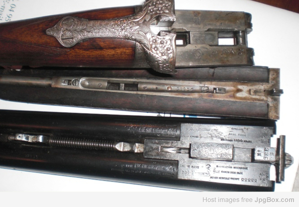

1). Didier Drevet barrel dated 1924; 1924 - 2?871 (or 1?871 ??); gun number 1080 for gun labeled "Excelsior." (per other ads for Excelsior's in the period which are chronologically serial numbered apparently). 10 gauge ( 19.2); chamber: 75mm (chambered in mm)(3"). modle EXCELSIOR .
http://www.naturabuy.fr/Fusil-juxtapose-Artisanal-Francais-occasion-Calibre-10-item-2824879.html
Excelsior is a well-known brand created by DD and SIFARM about 1924. Here is a gushing publicity for it. It's funny - if you read the ad on naturabuy.fr above - the guy doesn't know what is Excelsior, has not looked at his gun and claims it was possibly exhibited in Paris in 1900 - odd for a guy asking 2800 Euros for the arm)(research shows he bought it in 2015 at another auction). I'm starting to think some gun dealers are like carpet merchants.
http://fcm25.canalblog.com/archives/2015/05/22/32098981.html

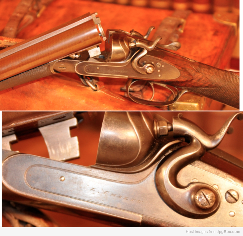

Per above: 3). Saint-Etienne guns up to about 1889 appear to be chambered in mm.. So they changed to cm about 1889 and back to mm about 1912. This 1889? change is very possibly the visible evidence of the change-over from the CGS system (centimeter, gram, second) to MKS system (meter, kilogram, second) in 1889 referred to by Wildcattle. This 1889 date is as clear a date-marker as the 1912 date. Here are a few examples:
-- notice that there is a gun chambered for 75mm and one for 80mm in this group.
1). from first page: 1878 Didier-Drevet fusil (damascus) date on the gun (not the barrel). 18.6 (11 gauge); 65mm Chambers. (Date on the gun).
2). Pre-1889 Fusil Darne rotary gun (the ad claims the gun is 1892 - this cant be since the chambers are measured in mm; -- unless of couse as Ted pointed out previously the barrels were made pre 1889 and then mated to the gun several years later). 16.8 (17 gauge); 65 mm chambers; Ronchard Cizeron barrels. (makes me want to ask that Kansas dealer, who has two of these, for photos of their barrel flats - how are they marked - in cm or mm? and who made the barrels?)
http://www.naturabuy.fr/FUSIL-DARNE-MODEL-ROTARY-1892-item-3675740.html
3). 1885-1889 Manufance under lever hammer gun; 75mm chambers; 17.4 (14 gauge). Manufance was founded in 1885; the chamber is in mm thus 1889 or earlier.
http://www.naturabuy.fr/Fusil-juxtapose-...em-3799057.html
4). Pre 1885. Saint Etienne under lever hammer gun Martinier Collin; 19.6 (8 guage - ad says 10 gauge but I think 10 gauge is 19.2); 80mm chambers; (Martinier and Collin founded the company which was sold in 1885; Their assistants then bought the company which ultimately became Manufrance.);
http://www.naturabuy.fr/rare-fusil-juxtapose-chiens-calibre-10-saint-etienne-item-2376357.html
5) 31). Pre 1889: Artisanal Saint-Etienne under lever hammer gun; 18.2; 65 mm chambered in mm. Identified as pre 1889 by the use of mm.
http://www.naturabuy.fr/Fusil-juxtapose-item-3475156.html

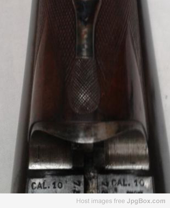

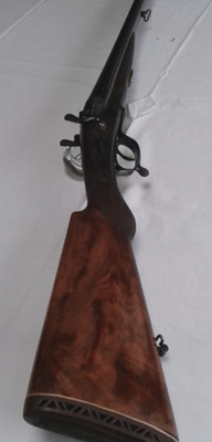

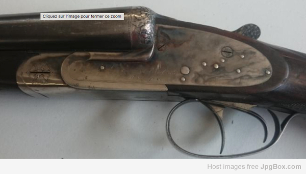

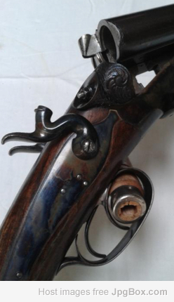

Just experimenting with date identification. I picked this gun from Naturabuy.fr because the seller is a bit obstreperous and some write-ins in a manner uncharacteristically rude for the French, have challenged his identification:
http://www.naturabuy.fr/Fusil-Cal-10-Manufacture-Armes-Cycles-Saint-Etienne-item-2206991.html
The ad says it is a Manufrance Ideal Jones underlever hammer gun tested for PP Pyroxillees powder; SN 19416; Cal 10; "80 mm chambers." Barrels are Ideal Hercule 3 Palmes demi-bloc. The ad claims that it was only available by special order overseen by the director of the workshop himself and would date from the period 1906-1914. In subsequent queries the seller mentions it was stamped Manufacture d'Armes et Cycles de Saint- Etienne. He blurs some pictures and cuts others off - Barrel flats can't be read, etc).
As a test case, here is my analysis: It may date from 1892-1900 - probably closer to 1900;
Manufrance - must be post 1885
Ideal must be post 1888
Chambered in cm must be1889 to 1912 (third picture of the forestock shows Cal 10, 7.5 - belying his claim the chambers are 80mm).
It is stamped with the Cycles address so must be post 1892.
Proofed PP so probably pre-1900.
The problem comes with the SN - have no idea how many guns Manufrance made from its creation in 1885 but 19,000 guns in 15 years (assuming they were consecutively numbered - which may not be) seems like a lot. And I wonder about the "Cal 10": 10 gauge St-Etienne guns I've looked at over the last few months are usually labeled 19.2 or thereabouts, not "Cal 10." Might be on the barrel flats of course.
Any observations? Am I close? (Im still learning).

Argo,
I believe only French powder PT is truly smokeless. The earlier powders PJ, PM, and PS were considered semi-smokeless.
The "Powder Pyroxles" may indicate proof with powder T, for sure 1900 or later.
Just a guess, as anything I know about Manufrance I learned by accident, trying to find out something about a Darne.

Thanks Ted...wasn't sure what "Pyroxillees" meant (smokeless?) and couldn't see the proof mark. So "PT"...post 1900 because of the powder; pre 1912 because of the chamber in cm. Pretty close to what the seller was advertising.
Edit, ran across this site on the manufrance Ideal:
http://www.gournetusa.com/ideal.htm
It dates an Ideal SN 21934 to 1903 and states that Manufrance was making 1500-2000 Ideal's a year. That would date the test gun above, SN 19416 to circa 1901, shortly after PT was introduced in St. Etienne.
The barrels came in different grades of Damascus or steel, stamped for the last one "ACIER HERCULE" followed by one to five pair of branches or palm determining the quality. If the Damascus were assembled with copper, the new steel was assembled with tin to keep lower temperature. Chopper lump, the technique used to assemble the locking lugs (dovetailed), are an integral part of the barrels. Chopper lump construction is believed to be stronger. The two lugs appear under the action and the model is stamped on the rear one. Here a "No 3R". The lowest grade is No 0. In 1187 were offered models 0 to 8. The letter R means that the barrels are compatible with smokeless powder and appeared in 1897. No 3R appeared in 1898. The barrels are stamped PS with a crown, a Saint-Etienne standard smokeless proof starting in 1901. There is on the barrels flat some indication of loading at proof and at regular use. Those barrels should have been proofed at 12,090 psi. The caliber available went from gauge 8,10,12,14,16,20,24,12mm and express caliber 500,450.375.303 british,405WCF,german 8x57, 600 Winchester and of course the 8 mm Label. The gun we have here is a 12 gauge chambered in 65 mm (very closed to 2 and half inch. Longer chambers, a 70 mm, were only available on a pigeon gun named "Perfection". It is a hercule steel 2 palms bored at 18.4 mm, 65 cm or 2 1/2 half inches. The rib is hollow, a typical feature of the Hexagone, they call it "canon plume" or feather barrel, and it weight XXXX. ..... Between the firing pin holes is stamped the serial number, 21934, year 1903. The average annual production those was 1500 to 2000 Ideal models.

Poudre pyroxylee, like poudre blanche, is simply a general term for smokeless powder. Does not refer to a specific powder, like PT, PJ, etc.
Posts: 9,446
Likes: 512
Posts: 9,446
Likes: 512
No, but, it does refer to smokeless powder, and only one French proof powder is truly smokeless.
Powder T.

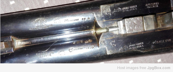

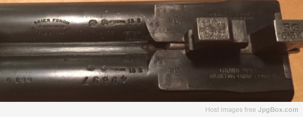

I'm continuing to compile a database of makers, barrel makers, marks, SN's etc 1880's to WWI. Here is a mystery for me. A "balance beam" trade mark on two different barrels. Any one have any idea what this means?
Example one, St. Etienne BLNE, 17.0 (16 ga), 6.5 chambers (in cm), double proofed for PT; SN is 23387 on gun, receiver, barrel. Here is the odd trademark: Above the "balance beam" TM appears to be the word "Depose"; below it (possibly) "Acier Comprese." It has to be post 1889 and pre 1913 (chambered in cm) and post c1900 (PT).
Example two: St. Etienne 18.2 (12 ga), 6.5 chambers (in cm), double proofed for PT. Ronchard Cizeron barrels (running rabbit mark on the barrel flats + the name). Gun SN on both receiver and barrel rib is 10,400. Above the "balance beam" TM appears to be the word "Depose" and below possible "Acier Tixphill"?? (second word unclear). It has to be post 1889 and pre 1913 (chambered in cm), and post c1900 (proofed for PT with the feathers). The gold medal could be the one given to Petrus at the 1904 St. Etienne exposition... meaning the barrel was made between 1904 and 1912 - or it could be one given to Ronchard-Cizeron in 1889 at the Universal Exposition (probably the latter since medaille d'or appears on RC barrels with Petrus's name).
There are two other identifying marks on this gun. Initial "D&C on the left barrel and "Choke Rectifie de Peuvel Petrus. Per this site, Petrus was a barrel maker, equipper, and barrel polisher before 1890. He received the Esoffier prize in 1895 and a gold medal at the 1904 St. Etienne exposition. He worked with Ronchard Cizeron and other prestigious arms makers.
https://www.pressreader.com/france/armes-de-chasse/20141216/281857231868305
Appreciate any help on the "balance beam" (or maybe a machine press?) TM. Thanks. Edit: The "Acier Compresse" is likely just a direct French translation of "Compressed Steel" which was used on the first Whitworth steel barrels in 1860's?
Found a couple of more Ronchard Cizeron barrels, first is 6.5 with the "balance" mark - looks like the words below are "Acier Comprime." Second is "65". (one pre 1912, the other post 1912). the mark does look like a press of some sort. I wonder if this is yet another Cizeron mark to go with the running rabbit?
Acier comprim = procd pour augmenter les caractristiques d'un acier donn par croussage. On augmente surtout la limite lastique au dtriment de l'allongement rupture en consommant les dislocations et lacunes du rseau cristallin. A l'poque, on faisait ce traitement chaud pour diminuer ou "supprimer" les dfauts de compacit du matriau.

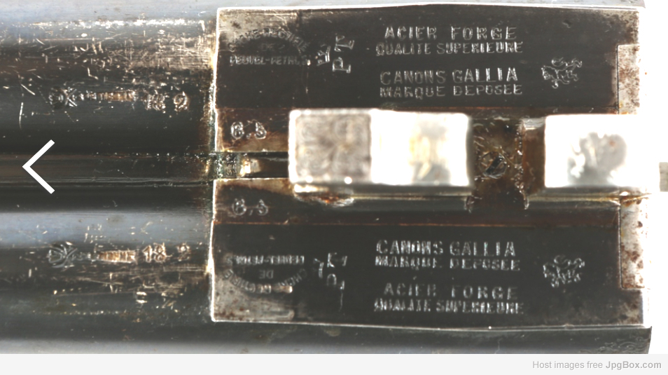

I know there's not much more to say but I continue to plow ahead...with proof marks, dates, SN's etc. It's already been done but I think I can make it easier for future French gun shooters.
Here is a question...a Ronhard Cizeron hammer gun barrel, 6.5 (1889-1912) with the "Acier Comprime" press symbol along with with PS proof. http://www.naturabuy.fr/Fusil-chasse-saint-etienne-chiens-calibre-16-65-item-3628117.html
Another site discussing a different gun says this about PS: "The letter R means that the barrels are compatible with smokeless powder and appeared in 1897. No 3R appeared in 1898. The barrels are stamped PS with a crown, a Saint-Etienne standard smokeless proof starting in 1901.". http://www.gournetusa.com/ideal.htm
I sure thought smokeless powder came with the PT mark from about 1900. So what is PS?
Posts: 9,446
Likes: 512
Posts: 9,446
Likes: 512
PS was an earlier, semi-smokeless powder. It continued to be used after 1900, but, had been in use prior to that as well.
The only R mark I've ever seen was for re-proof.

Argo, here's some information on powder that may help a little with dating. From an article in Gun Digest by Lee Kennett:
PJ and PS were both used as proof powders from 1896-1914.
PM and PR, same thing from 1898-1914.
PT came into use in 1900, and was the only powder used for proof post-1914.
Posts: 534
Posts: 534
before the "T" powder there were the S, J and M, with the corresponding proof marks.
I have a Pirlet boxlock with all three stamps PS, PJ and PM.
The "S powder was deemed the hardest to pass and was used by la manu long after T was introduced.
The "R" only applies to Ideal model # as in "No 3R".
The poster is correct in that it was supposed to be used in conjunction with Nitro proof relative to BP proof. It stands for "renforce" e.g. reinforced.

I think Kennett's reference to R powder likely comes from Baron Engelhardt, whose work he was basically updating. Engelhardt's original article shows the PM proofmark and says: "For barrels proved with smokeless R and M powders, adopted May 14, 1898. But it does not show a PR proofmark. He also shows only the PJ proofmark when referring to both J and S powders, which were adopted together on March 30, 1896. Looks like something slipped in the editorial process. Kennett's later article does show a PR proofmark.
Posts: 534
Posts: 534
there is no R powder!
Posts: 11,319
Likes: 71
Posts: 11,319
Likes: 71
Took a look in General Journee's "Tir des Fusils de Chasse". He doesn't list R, so it appears that Engelhardt was in error, and Kennett simply copied his mistake. Interestingly, Journee provides a chart which shows 4 different varieties of PJ. Only one each for the others (S, M, T).

Well I'm still curious about what Geoffrey Gournat is saying on this site referencing the manufrance Ideal:
"The two lugs appear under the action and the model is stamped on the rear one.... Here a "No 3R"...The letter R means that the barrels are compatible with smokeless powder and appeared in 1897. No 3R appeared in 1898."
The photos in the article show none of this. So is the "R" the author refers on the lug? Is it only relevant to Manufrance Ideals as Wildcattle said or does it apply to other Manufrance guns? The number in front of the "R" looks to be equivalent to the Ideal model number as Ted mentions but what about that "R"? It's odd that there is a definitive statement made about an "R" but no photo and no-one here has heard of it or seen it.
And finally French blogs are full of knowledgeable posters dating early Ideals and Robusts based on Serial Numbers. It looks like Manufrance records of their SN's are intact and known. Is this true?

It might be. The Manufrance building remains on Rue de la Convention, in St. Etienne, with the chamber of commerce building next to it, and the Darne works across the side street. The old Manufrance building stretches for more than a few blocks, and is enormous.
But, it has been divided up into retail space and shops. It had been out of business for some time when I was there, and I didn't seek out information on those guns.
Geoffroy speaks English as a third language, behind French and Waloon, and I have a bit of trouble communicating with him, and noticed much the same on his website. If you speak French as well as you write it, you could ask him yourself. He responds to email pretty much daily, in my experience.
If the folks on your French blogs are based in St. Etienne, they may well have been employed in the gun trade, or, moonlighted in it, and would have a depth of knowledge we here could never approach. At one time, a big percentage of the population in that town made their living, or part of it, in the gun trade.
As I have pointed out, Manufrance guns were not something I was, or, am, interested in. I'm sure they are superb guns. A friend owns an Ideal, a Costo and a Robust, nobody can hit anything with the Ideal, and the other two have been rode hard and put up wet, in addition to being hard to hit anything with. All three have pretty significant pitting in the barrels, not uncommon on old French guns, but, I've moved on from my pitted barrels phase. I was distracted enough with the Darnes, I guess.

Ted, my in-laws are down in St, Chamond. Their company has made parts for French Aerospace enterprises for 60 years. They're not In St. Etienne proper but are interconnected with the tech community there. We'll see what we can come up with. All of them talk about "La Manu"...Socialist France of the 1930's.
As for pitting in pre WWII French guns, a lot of those guns were buried during the occupation.
Of all the French bloggers..."Neltir" seems to be the best. He is irascible and grumpy but shares his knowledge.
French and Walloon are identical with a few idioms...now if you mention "Flemand"..that's another story.
Ted, there are dozens of identifying markers for early 20th century French guns..This line has been a great education for me...and I will compile what we come up with.

WC commented above: "Nitro proof relative to BP proof."
Curious about "BP proof." You guys know this but might clarify what this is and when it started ended. Edit: That's the mark for Jean Bruel..the barrel maker
Here is a line about Zapatto Freres gun with a BP on the barrel we never identified; is this the BP referred to? http://www.doublegunshop.com/forums/ubbt...2760#Post442760

No photos of the "R," but re-reading Geoffrey and Wildcattle's posts, I think WC meant the "R" is a stamp on the lug of a Manufrance Ideal which is supplemental to the proof stamp meaning it has been proofed for Nitro...similar to the "BP" Biirmingham proof...i.e. it will be in addition to the PT, PS.. stamp(s)..and the Ideal model number will precede the "R". Haven't seen it myself but would like to see a photo for historical reasons....and to know when that started and ended.
And this ad for a book on Guns International answers my previous question about Manufrance Serial numbers - guess I should get the book and will do so next time I'm in France.
Le Fusil de Chasse "Ideal" by Jean-Claude Mounrnetas
Description:
This soft bound book is about the history and development of the Manufrance Ideal model round action trigger plate shotguns and rifles with many pictures and diagrams and the coveted serial number to date chart.
http://www.gunsinternational.com/guns-fo...un_id=100397050

In any event, here is another gun I'd like to date because I believe it gives a time marker for dating Zavattero Frerres shotgun serial numbers. This gun is on gunbroker: http://www.gunbroker.com/Item/688306821
The seller doesn't know the model or date - I believe it is Zavattero Frerres made between 1908-1912..SN 49697.
-- Per the last image I believe this is Zavattero Frerres (we went through this in another line and decided the letters in the oval were ZFr) http://www.doublegunshop.com/forums/ubbthreads.php?ubb=showflat&Number=443491&page=1
-- Chambered in centimeters (cm) so 1889 - 1912
-- Proofed for PT - post 1900
-- Received a prize in London 1908 - so post 1908 (I've confirmed ZFr received a prize at the 1908 London Exhibition).
ZFr was founded in 1880 and lasted until 1965. (This gun doesn't have the CZ or FZ stamps which were ZFr models which came out in the 1920's).
I don't know the SN of the ZFr gun we commented on above (previous) line - it wasn't photographed. I believe the guns were consecutively numbered more or less....and will try to expand on this. There's a ZFr gun on Passion la chasse SN 97701 with a comment by Neltir which he dated to July 1951.
(Graph points:
.....1880 - 0;
.....1910 - 49697;
.....1951 - 97701 ( minus four years 1914-1918)(and 5 years 1940-45)
a graph could be constructed but the SN's for the company must exist somewhere because Neltir had the SN down to the month).
(http://www.passionlachasse.com/t22381-identification-fusil-juxtapose
The barrels for that gun were made in Belgium by Lovenfosse Hardy & Fils - I think he refers to the crossed rifles with stars at the bottom of the proof:
By the way I knew I'd seen that logo "BP" or whatever before. It's on the barrels of the French "Wonder" lock gun I posted to show that my plain Jane war trophy 12 bore was not alone. http://www.doublegunshop.com/forums/ubbthreads.php?ubb=showflat&Number=449178 It looks like it's actually "JB" and that we've been looking at it upside down. I wonder if it is actually a symbol for barrel makerJean Breuil? (Not sure of this - the font looks identical but to contort the BP into a JB would require some doing - maybe having it stamped backwards).

Come on you Fusil de Chasse Jusxtapose Francophlies. All of you have lots of dating data. And you are cache-ing it like a French chef (who would never ever give you the whole recipe). It's now time to give up your secrets and post it here - even if piecemeal. We can "crowd source" the time chart. (if it has x it's post yyyy... etc.).
And all those anonymous serial numbers on Saint Etienne guns? Someone - one of the 120 gun makers in the city - put them there. Compile a chart..you'll get a statistics type of answer. (look at that "wonder" lock - we now have two datapoints...and can build on that).
(I'm tempted to buy that book on the IDEAL and scan the SN chart...everyone in France seems to have it.). And I'm wondering how many more records are out there.

Gene,
I always assumed that little mark you are seeking information about was a barrel makers mark. I have seen it a few times, but, never had a manufacturer to associate it with. There were likely dozens of barrel makers in France in that era.
I have no firm information on that mark, however. I, also, doubt the proofhouse would have stamped it on the rib.

Gene,, I have the book and will scan it for you. Although I won't be home until Tuesday.
Much as I think highly of French guns, my French Collection currently consists of just an Ideal and a Parisian sidelock. So not much help in the piecing together of the St Etienne history.

Here's a list James sent me some time ago regarding the Ideal. I'll scan Mournetas Robust models and dates of mfg in a day or so. I will also scan the model numbers and dates mfg. for the Ideal models and dates:

Amazing. Ask a question and guys start pulling stuff out from under their beds. It's so difficult to date Saint Etienne guns.....except maybe it won't be that difficult anymore. Simply amazing.
Edit, while here, I want to repost the Darne SN chart previous forwarded. Ted warns that there are some demonstrable inaccuracies but it is a reference tool:

Gil has scanned his book on Manufrance and forwarded the following Serial number list for the Ideal and Robust. Here are the tables for the IDEAL. I'll translate the first half of the first page per below:
Dating of the IDEAL by Registration Number
Currently, three lists are circulating concerning the dating of the IDEAL by their numbers. One at least is complete fantasy, having been established by suppositions about what has been written badly interpreted. Another of a more serious origin seems to have been established according to the production of the barrels. This has nothing to do with the finished arms delivered for sale each year.
On this topic we have an official document furnished by the head office of the manufacturer on page 45 of the 1898 catalogue. Here below is the total production of the IDEAL shotguns for the first 10 years (11,732 shotguns produce in total):
1887: 630
1888: 1,152
1889: 1,925
1890: 2,713
1891: 3,724
1892: 4,683
1993: 5,761
1894: 6,995
1895: 8,107
1896: 10,239
1897: 11,732
These numbers corroborate those in the document given by the official source that we are publishing below.
(Note, these posts have come out quite fuzzy - probably because of the host photo resolution. I will work to get better copies and/or will type it out manually as time permits.) (edit: I'll post the page on the numbers produced and serial numbers up to 1945 hand typed below. But frankly there are some almost indecipherable - to me at this point - additional pages that I don't understand unless I get concrete examples):
Year..Production.Serial Number
1887 . . . 630 . . . . . . . 001 to 630
1888 . . . 522 . . . . . . . 631 to 1152
1889 . . . 783 . . . . . . 1153 to 1935
1890 . . . 778 . . . . . . 1936 to 2713
1891 . . .1011 . . . . . . 2715 to 3724
1892 . . . 959 . . . . . . 3725 to 4683
1893 . . .1078 . . . . . . 4684 to 5761
1894 . . .1234 . . . . . . 5762 to 6995
1895 . . .1112 . . . . . . 6996 to 8107
1896 . . .2132 . . . . . . 8106 to 10239
1897 . . .1493 . . . . . .10240 to 11732
1898 . . .1509 . . . . . .11733 to 13241
1899 . . . 814 . . . . . .13242 to 15055
1900 . . .2008 . . . . . .15056 to 17083
1901 . . .2014 . . . . . .17084 to 19077
1902 . . .1637 . . . . . .19078 to 20714
1903 . . .1489 . . . . . .20715 to 22203
1904 . . .1489 . . . . . .22204 to 23692
1905 . . .1798 . . . . . .23692 to 25490
1906 . . .1913 . . . . . .25491 to 27403
1907 . . .2040 . . . . . .27404 to 29443
1908 . . .2094 . . . . . .29444 to 31537
1909 . . .2014 . . . . . .31538 to 33551
1910 . . .1875 . . . . . .33552 to 35426
1911 . . .1742 . . . . . .35427 to 37168
1912 . . .1700 . . . . . .37169 to 38868
1913 . . .1000 . . . . . .38869 to 39868
1914 . . . 717 . . . . . .39869 to 40595
1915/19180
1919 . . . 506 . . . . . .40596 to 41091
1920 . . .1282 . . . . . .41092 to 42372
1921 . . .1306 . . . . . .42373 to 43680
1922 . . .2191 . . . . . .43681 to 45871
1923 . . . 655 . . . . . .45872 to 48526
1924 . . .2561 . . . . . .48527 to 51087
1925 . . .2809 . . . . . .51088 to 53896
1926 . . .2861 . . . . . .53897 to 56757
1927 . . .2819 . . . . . .56758 to 59576
1928 . . .2884 . . . . . .59577 to 62460
1929 . . .1367 . . . . . .62461 to 63827
1930 . . .1816 . . . . . .63828 to 65643
1931 . . .1624 . . . . . .65644 to 67267
1932 . . .3894 . . . . . .67268 to 71162
1933 . . .1538 . . . . . .71163 to 72700
1934 . . .1000 . . . . . .72701 to 73700
1935 . . . 101 . . . . . . 72701 to 72801
1936 . . . 496 . . . . . . 73802 to 74209
1937 . . .1990 . . . . . .74210 to 76199
1938 . . .1859 . . . . . .76200 to 78058
1939 . . . 368 . . . . . .78059 to 78426
1940/1945. 0
The preliminary dating of an Ideal in an above post SN 19416 (page 5,6) can now be checked. It was initially identified as pre 1900 based on chambers in CM, proofed for PP, etc. Ted commented that it was actually proofed for PT, so the date was moved to post 1900 possibly 1901. Per the above chart 19416 would have been made in 1902. The seller claimed 1906-1914.

There are elements of this chart that I just don't understand. Bis is the French equvilent of "sub-category" or of 1 and 1a. Tre is the equivalent of a second sub-category, But without examples, I just can't read these charts. Perhaps someone can interpret. (edit: These are model numbers.)
I'll give a rough translation of the last paragraph.
Warning: the user can expect to find a chart on the beginning or the end of a model number series for the IDEAL from the end of the 19th and from the beginning of the 20th century and in effect Manufrance published 4 catalogues for the public at large per year, and one or two deluxe editions and several other catalogues specially for gun shops. It is not unusual to find that a type of gun or model was proposed at the beginning of a year and not in the last trimester (or the inverse). This is simply linked to production objectives
I therefore set out to make a chronological model number identification chart which would be the closest to reality such that the collector or the amateur might have a base in order to detect fantastical markings, false markings or the refitting of replacement parts from various sourses.

For the Robust: Can anyone interpret these umbers?
Posts: 4,030
Likes: 397
GLS Offline
Posts: 4,030
Likes: 397
Gene, those are model numbers and years mfg'd for the Robust. For example, I have a Robust 226 which appeared in 1931 and was last made in 1940. Gil

Got it Gil...I had to translate the last paragraph on the IDEAL to understand. Still don't quite understand the 1 - 1 bis, etc... So no Serial numbers for Robusts - just model numbers?

"Bis" means two (or twice) in Latin, and "ter", three.
In this case my catalogs show that many grades could be ordered with an extra quality for 10FF more. There is a blurb early in the catalog, explaining those are just better than average guns giving better results for range and accuracy. Looks pretty arbitrary to me, and a marketing ploy to up-sell, no doubt.
I did not see a "ter" in my 1900 and 1910 catalogs but undoubtedly it would be a similar thing.
I have never seen an ideal marked "bis" or "ter" so there is probably no way to know now what the difference was...

Add a little new to the topic. Several years ago I bought ROBUST 24. As I saw from the list, this model was made from 1925 to 1930. The gun is working, I go with him to hunt for a duck. May be anyone have more info about this model?
Posts: 534
Posts: 534
That's a weird one.
I would say that the only French thing on this gun is the action.
The barrels, forend and stock are German.
Probably a WWII adventure...
WC-
Joined: Nov 2017
Posts: 3
Joined: Nov 2017
Posts: 3
You think?
It seems to me on the barrel stamps Saint-tiennee ( S with a crown).
Posts: 10,591
Likes: 159
Posts: 10,591
Likes: 159
No, the tubeset is purely German. Is the stamp of the MF paired w/ a wreath surmounted by "Saint" a stamp of Manu-France?

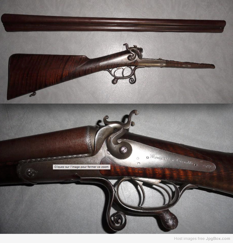

I'm going to post a Didier Drevet shotgun. SN 5275: dated 1887, a complete gun , chambered for 75mm. The gun has 30" Damascus barrels and was for sale for 750 Euros. - would that I been involved in Doubleguns when it came up for sale in 2012!
1) This adds to the graph of DD historical serial numbers.
2) It also gets closer to the theorized 1889 changeover date from mm to cm, when as WC pointed out France changed from the CGS system (centimeter, gram, second) to MKS system (meter, kilogram, second).
And what's with the brown case color?
FUSIL DE CHASSE percussion centrale, chiens extrieurs, deux coups, calibre 12-75 (18). Canons damas juxtaposs de 76,5 cm de Didier Drevet. Platines graves " L. Chalet Saint Etienne ". Crosse en noyer quadrill, marque sur une pice de laiton aux armes couronnes de Poncins. Dans un tui jambon en cuir " Count de Poncins ". Fabriqu en 1887.
N5275 - 1887. Poids: 3,370 Kg.
5 catgorie.
Adjug: 750
https://www.rouillac.com/fr/lot-233-79107-fusil_chasse_percussion_centrale_chiens?p=9

And I'll post this 10 gauge Didier Drevet for history's sake. I believe the SN is 3675, and is dated 1879..very difficult to make out but I believe this is in the ball park. Chambers not mentioned.
https://www.naturabuy.fr/TRES-BEAUX-FUSIL-CAL-10-DAMAS-DIDIER-DREVET-item-4124257.html
TRES BELLE PIECE CAL.10
Beaux fusil du CANNONIER DIDIER DREVET sign sur les canons et poinons du cannonier DIDIER DREVET ST. ETIENNE et marquage mdaill en 1855
Canons DAMAS brun tabac, intrieur brillant mais marqus sans gravit vu l'paisseur de ceux-ci
Belles signatures sur les platines MONIN Bt. A GRENOBLE
Belles gravures avec cle sous pontet avec de belles volutes et beaux pomeau travaill
Plaque de couche fer et toutes les vis sont d'origine
Trs beaux bois tigr

This line further refined the date of the changeover from cm to mm in Saint-Etienne - to at least post 11 June 1912
https://doublegunshop.com/forums/ubbthreads.php?ubb=showflat&Number=578429&page=3
"We've established that the change back to mm to measure chambers from cm in Saint-Étienne occurred in 1912. We don't know exactly when. But:
-- it was definitely 1912 per dated Didier Drevet barrels
-- On the Darne number chart (Ted will caution about exceptions) it happened just around serial C600-700 (1912 per the chart):
. . . . . . .- C692, a 12 gauge with a chamber stamp "6.5".
. . . . . . .- C643, a 20 gauge with a chamber stamp "70".
Now if Berthon Fréres trademarked "Canons Gallia" on 11 Jun 1912...then you've likely dated your gun to within a couple of months - summer 1912. (And incidentally we've established that the changeover to mm was after 11 June 1912).
Raimey, you and I were thinking the same thing. I suppose it's possible he was using Canons Gallia before the trademark...but....heck...lets date the gun.
David, the common idea in gun scholarship is that it's darned difficult to date a Saint-Étienne gun - there are no French dating stamps. But by chance, dating your gun doesn't get much better than this."

Translation: Per this advertisement, a Robust serial 38710 with chambers in cm. I don't think that that arm was made in 1912 because it was sold beginning in 1913. I think that the chambering in cm ended after 1912:
https://www.naturabuy.fr/Fusil-ROBUST-N-2-item-7476679.html
Reply: Merci Fab comme d'habitude: Cette (un arm, une fusil?) Robust est vraiment interressant.
Cependant, notre conclusion que le changement de cm a mm a Saint-Étienne banc d'épreuve était en 1912 était basé sur cette fusil-de-chasse avec canon par Didier-Drevet avec une date 1912 - chambre en mm. Je dois me demander si les canons pour le Robust avait été deja a la banc d'épreuve en 1912 avant la creation du Robust?
(However, our conclusion that the change-over from cm to mm at the Saint-Etienne proof house was in 1912 was based on this shotgun with barrels by Didier Drevet with a 1912 date - chambered in mm. I must wonder whether the barrels of the Robust might have been to the proof house in 12912 before the release of the "Robust?")
--. 1912 13689? 18.4; 65 chambered in mm; Note the 1912 shift to mm.

Raimey, Fab500 read our line and posted a "Robust" barrel (which came out in 1913) with chambers in cm. This challenged the thesis that the change to measuring chambers from cm back to mm in Saint Etienne was summer 1912 as postulated. He believed it was later possibly 1913+
I posted
-- the "Gallia" barrels which had chambers in cm..certainly made (or stamped) after the name was trademarked in 11 June 1912.
-- And a Didier Drevet barrel dated 1912 with chambers in mm.
Which indicates the change-over was indeed in 1912 sometime after June of that year.
But how to explain that "Robust" barrel? First..it looks odd...it has the French comma for a decimal point - all the other guns chambered in cm from 1889 - 1912 use a simple decimal point. So I don't take that as definitive. What I hope is that FAB500 will post some of this on some of the French sites and we'll get a flood of information.

Hello all, this is my first post. Not sure how to add pics on here yet. Has anyone ever seen a 32 Guage Saint Etienne "& cycles"? I do have one and it's definitely a 32 Guage.

Shane, suggest you post this on a separate independent line. That'll give others the chance to see it and respond. To post pictures you have to use a free photo-hosting site such as jpgbox.com or imgur.com. It you want to send them to me via email, I'll post them on the separate line. See PM.

https://www.naturabuy.fr/Fusil-Didi...brication-1919-item-10692017.html#viewer
Salut Argo,
Canon Didier-Drevet de 1919, confirmé par le vendeur, avec un chambrage en cm.
Joined: Nov 2020
Posts: 107
Likes: 20
Joined: Nov 2020
Posts: 107
Likes: 20
[Linked Image from i.goopics.net]
Canon d'un fusil Idéal avec un chambrage en cm.
D'après la liste de JC Mournetas, ce fusil daterait de 1924.

Thanks Fab. But I have doubts about all three guns. One of them is clearly dated 1905 per the comments There is a lot of overstamping and one wonders if barrels were being reused or stockpiled barrels were being employed in later guns.
I have a pretty good idea on dating the Didier-Drevet barrel serial numbers. Could you please forward better pictures of the barrel flats and the stampings under the barrels including the DD serial numbers. (From experience I trust only photos - not claims by a gun seller) Thanks and thanks for doing this research. Gene.
Merci Fab. Mais j'ai des doutes sur les trois armes. L'un d'eux est clairement daté de 1905 selon les commentaires. Il y a beaucoup de surimpressions et on se demande si des canons étaient réutilisés ou si des canons stockés étaient utilisés dans des armes ultérieures.
J'ai une assez bonne idée sur la datation des numéros de série des canons Didier-Drevet. Pourriez-vous s'il vous plaît envoyer des meilleures photos des plats du canon et des estampages sous les canons, y compris les numéros de série DD. (Par expérience, je ne me fie qu'aux photos, pas aux affirmations faites par un marchand). Merci et merci pour cette recherche.
Et felicitations pour le 14 Juillet!!! 234 ans. Chez nous aujourd'hui:

Salut Argo,
Je comprends tes réticences, mais pour moi, il ne fait aucun doute que le date inscrite sur le canon est 1919. Le vendeur me l'a bien confirmé.
Pour le numéro de série, je pense à 14340 ou 14540 ou 14740.

Didier-Drevet barrel SN 14340(?) would likely have been 1919 per the chart on the first page. I think that "Skeetz's" DD 14204 dated 1918 chambered in mm was one of the first Didier-Drevet guns produced after the war.
Didier-Drevet canon SN 14340 (?) aurait probablement été 1919 selon le tableau de la première page. Je pense que le DD 14204 de "Skeetz" daté de 1918 chambré en mm fut l'un des premiers canons Didier-Drevet produit après guerre.
There are definitely DD barrels chambered in both CM and MM dated "1912." So I think this SN 14340 gun must be a sort of "outlier." Perhaps the barrels were stockpiled during the war?
Il y a certainement des canons DD chambrés en CM et MM datés de "1912". Je pense donc que SN 14340 doit être une sorte de "valeur aberrante". Peut-être que les canons ont été stockés pendant la guerre ?
Here is the extant gun chart from p. 4 on this line with DD dated serial numbers. (we need to post this on Passion la Chasse and get more data input). (Nous devons publier ceci sur Passion la Chasse et obtenir plus de données)

1912 - 13689? . . 65. .mm; 18.4: Note the 1912 shift to mm. (page 4)

Here is the best I can do for resolution on 14340

And this is the problem with Naturabuy - marketing: Somehow the sellers can't bring themselves to post really good photos (the disease is universal: English auction houses post good photos but not of barrel and action flats; guntrader and gunstar are often awful).
Here is a Didier-Drevet barrel (part of the two forwarded by FAB500) which per the comments on the gun is dated to 1905. Not a chance to confirm the SN or the date from this crappy photo.
https://www.naturabuy.fr/DIDIER-DREVET-LUXE-PLUME-16-65-item-10456388.html

Salut Argo,
Le 11 juin 1912, Berthon dépose la marque "Canons Gallia".
Le 12 février 1919, la marque "Canons Gallia marque déposée".
Si j'en crois mes sources, ce fusil est postérieur à 1918.

1). 1912 13689? 18.4; 65 chambered in mm; Note the 1912 shift to mm.

I took a second look at the 1912 DD barrel. I had recorded the number and photo when it was posted on Naurabuy. That posting no longer exists. However, trying to blow it up and make it clearer, the date could conceivably be 1918 - SN 17982.
J'ai jeté un deuxième coup d'œil au canon 1912 DD. J'avais enregistré le numéro et la photo lors de sa publication sur Naurabuy. Cette annonce n'existe plus. Cependant, en essayant de le faire exploser et de le rendre plus clair, la date pourrait être 1918 - NS 17982.
Wildcattle noted that the change from the CGS system in Saint Etienne (centimeter, gram, second) to the MKS system (meter, kilogram, second) occurred in 1889. He believed the change back to the CGS occurred around WWI. Since I may have mis-read the 1912 . . .we'll re-open the question. A 1918 date would certainly make it easier to fit-in the Robust and the Canons Gallia.
Wildcattle a noté que le passage du système CGS à Saint-Étienne (centimètre, gramme, seconde) au système MKS (mètre, kilogramme, seconde) s'est produit en 1889. Il pensait que le retour au CGS s'était produit autour de la Première Guerre mondiale. Comme j'ai peut-être mal lu le 1912 . . .nous allons reouvrir la question. 1918 faciliterait certainement l'intégration du Robust et des Canons Gallia.
But for sure the change back to CGS had to have occurred by 1918. There is no mistaking the stamps on Skeetz's barrels.
Mais il est certain que le retour à CGS a dû avoir lieu en 1918. Il n'y a aucun doute sur les timbres sur les canons de Skeetz.
So now we need more Didier-Drevet dated barrels.

Mike, is that top picture your Didier Drevet 1918 SN 14204? If so, it's clearly 6.5 cm and my thesis about 1912 let alone 1918 being the changeover year is wrong (unless the above SN 17982 is in fact "14982" and the date is 1918).
I'm now not sure that SN 15034 (date not pictured) that I said was undated is actually 65mm. The chambered numbers are obscured but are suspiciously far apart and could be 6.5:
The earliest dated Didier-Drevet barrel chambered in mm (after the 30 year break) now possibly is 1918? - 17982?? above - and 17982 is not a 1918 SN; both numbers are not clear.
The next dated Didier-Drevet barrel is on this 1924 gun:
1). Didier Drevet barrel dated 1924; 1924 - 2?871 (or 1?871 ??); gun number 1886 for gun labeled "Excelsior." (per other ads for Excelsior's in the period which are chronologically serial numbered apparently). 10 gauge ( 19.2); chamber: 75mm (chambered in mm)(3"). modèle EXCELSIOR. (This is from the Naturabuy advertisement. The photos show a chamber of ".655" whatever that means).
So now we're up to at least 1918, possibly as high as 1924 for the changeover year. We need more DD dated barrels or more solid analysis, maybe an Ideal dated per JC Mournetas or some other gun with a date marker, to determine when the first mm chambered gun came back to Saint-Etienne. FAB, as usual, was right.
Nous en sommes donc maintenant à au moins 1918, peut-être jusqu'à 1924 pour l'année de basculement. Nous avons besoin de plus de canons datés DD ou d'analyses plus solides, peut-être un Idéal daté par JC Mournetas ou un autre fusil avec un marqueur de date chambre en mm, pour déterminer quand le premier canon à chambre mm est revenu à Saint-Etienne. FAB, comme d'habitude, avait raison.

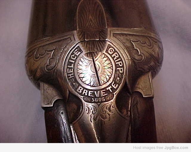

Mike, 19488 is the SN of the gun, not the barrel. What I can't figure is the Helice-Gripp (supposedly Verney Carron) but with the top lever screw visible, indicating it's likely a Scott Spindle knock off. Now I'm out at sea trying to figure out the first mm chambered Saint-Etienne gun after WWI; I'm still holding onto 1918 but barely based on the fuzzy photos of 17982. What is the gun with the Canon Marsot?
Posts: 5,444
Likes: 146
Posts: 5,444
Likes: 146
With the Canon Marsot, they are NO, NONE, ZIP external markings
Clever devils at work. I was about to comment that the VC catalog (1922) lists "Helice Grip" as one of their registered trademarks. But now I see that the maker of the above gun simply added another P to Grip.

Couple of Didier-Drevet barrels to add to the list. . .including a clearer picture of one of the guns forwarded by FAB500:
1908 - 12707; 6.5 cm; 18.4; Gun Maker: ??; gun sn: ?? Decorative boxlock - two buttons under the forearm to eject one or two shells.
https://www.naturabuy.fr/Fusil-juxt...evet-Grand-Prix-1900--item-9374215.html.
xxxx - xxxxx; 6.5 cm; 6.5 cm; 18.4, 70 cm barrels; highly engraved boxlock. Action or gun made bu "Boxberger"? (I will attempt to get date and SN from the seller)
Salut Argo,
Ne t'embête pas trop avec ce fusil. Les canons ont été coupés après les chambres et ont été remplacés avec des nouveaux par frettage.

Gene,
‘Coupla years past, I warned you this would be daunting. That mono bloc, mated to a set of barrels produced by someone else, is something that hadn’t even occurred to me, sleeving not being as acceptable on the continent as in Olde Blighty.
One more factor to factor in.
Good luck.

Merci FAB, je ne me suis pas rendu compte.
Ted, I thought we had it nailed down but then took a look at the "1912" gun and found it questionable and Skeetz's 1918 turned out to chambered CM not mm.
It's easy solution though - we just take this gun out of the list. Still looking for the first reliable dated Didier Drevet barrel chambered in mm since I don't trust the photo of the "1912 or 1918" gun above.
Here is the latest chart of guns with dated Didier-Drevet barrels confirmed by photos:

1918?- 13986? . . 65. .mm; 18.4: ??????? 1st mm chamber??
1918 - 14204; . .6.5. .cm; 18.4: Gun maker: ?? gun sn: 19488; (Skeetz's gun)
1919 - 14340; . .6.5. .cm; 18.4; Gun maker: ?? gun sn: ?? La bascule jaspée avec son axe d'origine porte la signature en lettres cursives « Didier Fusil 1919.09.23 » . Une inscription en majuscules vient la compléter sur la table : « MARQUES DÉPOSÉES D.D-1919-23 ».
1919 - 14341; . .6.5. .cm; 18.4; Gun maker; ?? gun sn: ??
1921 - 15034; . .6.5? .cm; 18.4; Photo is unclear but 6.5 is the best guess

https://www.naturabuy.fr/DIDIER-FUSIL-modele-Excelsior-canons-plume-EUREKA--item-8947087.html
Fusil fabriqué dans la période Laspoussas-Driol. L'arme est signée Berthon frères. Les canons sont de Jean Breuil.

Now I'm looking for dated Didier-Drevet barrels from 1918 - 1924. But still, this 1901 Darne fitted with DD barrels 1901 - 9451, Darne gun SN "1508", is interesting. Normally without a picture of the barrels and flats I wouldn't post the gun but the description has integrity.
https://www.proxibid.com/Guns-Milit...G-BREECH-SHOTGUN/lotInformation/55657580
DARNE V SERIES 12 GA SBS SLIDING BREECH SHOTGUN | Darne V Series 12 gauge side-by-side sliding breech shotgun. 2.5" chamber. 27.5" barrels. 13" & 13.75" LOP. Matching serial numbers throughout. Bottom of barrel flat reads: "Non Pour La Ball *choke* Eureka," St. Etienne," "Canons Plume," 18.4" indicating 12 GA bore and 6.5 indicating 2 1/2" chamber. Fusil Pour Poudre Pyroxylle," Medaille 1855," Didier Drevet," Cannonnien a St Etienne," "Modele Depose," "Canons De Sjrfte Garanti Double Epreuve," "1901.9451," and crown over "PS" proof mark. Highly decorative floral engraving on receiver, barrel shank, trigger guard and T lever. | Provenance: | Search: “Buie” within this auction catalog to filter & view all of the Col. Walter Buie lots included in this auction. | WWII War Trophy Collection & Military Archive of Col. Walter Buie | Only recently discovered, the extensive WWII War Trophy Firearm & Militaria Collection of Colonel Walter Buie has been stored away within the original boxes and trunks in which the items were shipped back by Buie from his WWII service in both the European and Pacific Theaters. | The Buie collection is comprised of hundreds of pieces, acquired by Buie while stationed in Germany and Japan. The war trophies were then packed into trunks and wooden crates for shipment back to the States. When found, the items were still contained within the original trunks and crates. Opening each was an exciting discovery, akin to opening a time capsule where one did now know what historical artifacts await. | Centurion Auctions, auctioneers & appraisers specializing in wartime collectibles and firearms, have been commissioned to bring the Buie collection to market. | The firearms are included in the August 2020 Firearm Auction and consist of approximately 50 pieces, many of which are quite scarce. | The military collectibles are included in the September 2020 Wartime Collectible Auction and include hundreds of items. Also included in the militaria session are personal items related to Buie and his military career. | Colonel Walter Daniel Buie (1900-1986) was born in Nashville, Georgia, and graduated from the United States Military Academy West Point in 1920. He served in various military positions in the United States and abroad for the next 24 years, and in 1941 was assigned as an instructor at Command and General Staff School at Fort Leavenworth, Kansas. In 1942 he was promoted to colonel. He became chief of staff for the 97th Infantry Division at Fort Leavenworth in 1943, and soon after was reassigned as chief of staff to the newly-activated XXIII Corps at Camp Bowie, Texas. On September 5, 1944, Buie was named regiment commanding officer of the 272d Infantry Regiment (“Battle Axe Regiment”) of the 69th Infantry Division. Shortly after, the 272d Infantry was sent overseas, first to England and then to France, Belgium and Germany. In March 1945, the 272d Infantry occupied the front line position of the Siegfried Line, pushing back the German Army, before advancing to the Rhine River. The 272d continued its path across Germany, capturing Fortress Ehrenbreitstein and clearing over 35 towns along the way, including Leipzig. The 272d Infantry eventually made contact with the Russian Army in Berlin in late April, after the Russian Army had already taken the city. The war in Europe ended with V-E Day a few days later. Colonel Buie was immediately transferred to the Pacific Theater, where he served as chief of staff for the 25th Infantry Division and was present for V-J Day. After the war ended, Buie stayed in occupied Japan at the headquarters of General Douglas MacArthur’s Far Eastern Command. He returned home to the United States and retired from the military in 1954. He held various government positions after retirement, including with the Federal Civil Defense Administration and the Office of Emergency Preparedness. Buie died in 1986. | Caliber / Gauge: 12 GA | Barrel Length: 27.5" | Serial Number: 1508 | | Condition: Very good. Very good bores. Shows some wear, age and loss to finish. Some minor oxidation marks on barrel. Functions properly. | Est. $700-1000

As I continue to struggle with the cm to mm changeover in Saint-Etienne, this gun keeps popping up:
It was originally interpreted as 1912 - 13689 and was the original marker for cm-mm changeover. FAB500 kept turning up exceptions and a second look at the barrels, blowing them up, etc., raised questions about the date and the DD serial number.
I now think the date SN could be 1918 - 13986... chambered in mm, which would mark the beginning of a new dating era. (or possibly 1919 - 14986?)
Comparing the fuzzy photos with similar fuzzy photo from 1919 - 14341 seem to support this. The "7" likely is a "3." Mysteries and contradictions and bad photography confound expectations. But whatever, 1919 or 1918 this gun is still chambered in mm is clearly the first extent gun found after WWI chambered in mm.
There is a good sample on p.16 above of DD barrels which can give a good idea of how many he was producing. What we really need now are dated barrels from 1885-1895; and from 1910 - 1924.

Another Didier-Drevet Canon-Plume barrel comes to light. 1919 - 14340; 6.5.
https://www.naturabuy.fr/Fusil-Didi...-6kg-fabrication-1919-item-10692017.html
From the advertisement on Naturabuy, believe this is a Didier Fusil make. I'll post the ad because in spite of the hype (it's a plain Jane gun but advertised as a historical gem), it has some interesting information that I've yet to confirm - the important point in the last paragraph:

Gene,
Notice the font of the letters of the word “DARNE” on the opening lever? That is an old gun.
Wish I would have been at that auction with $700-1K that day. Neat old gun.

I'll give a shout out to French quality. Here is a Saint-Etienne SxS 12 bore scroll back filed boxlock, side clips, tasteful engraving and excellent wood, with Didier-Drevet post 1900 plume barrels (unfortunately sleeved so the SN and date are not known). (Note the Scott Spindle rather than a copy of the Verney Carron "Helice Grip":
https://www.naturabuy.fr/Fusil-juxt...revet-Grand-Prix-1900--item-9374215.html
Salut Argo,
Je ne connais pas la date du décès de Jean-Pierre Didier.
Par contre son fils Jean Didier, qui au début du XXè siècle réunit les 2 canonneries Didier-Drevet et Ronchard-Cizeron qui cesseront leurs activités en 1924, est lui décédé en 1940.

Good afternoon. Need help identifying the manufacturer of the gun. The barrels have Saint-Etienne markings and Suhl markings as well.
[img]https://photos.app.goo.gl/ZLZo81SFdpyeAeJ26[/img]
[img]https://photos.app.goo.gl/e3MiU7N7uWLETxRe7[/img]
[img]https://photos.app.goo.gl/2Eu5dzbzGNeGzwDJ7[/img]
[img]https://photos.app.goo.gl/yWeQ772btKLkGNxi6[/img]
[img]https://photos.app.goo.gl/oTaeq1apQqjBv7mh9[/img]

general observations: the gun appears to be a normal basic grade french gun - built with the v-c type helice fastening system....the lever markings do not misspell the word helice (as many such examples do - might be a later production). T powder, 65mm chambers - so built after 1912-1920 (?), acier martele - i have seen before, but don't recall any details. the oval D-R mark on the water table is not familiar to me, nor are the very stylish circled initials on the barrel flats - which i read to be a stylized A R. two additional marks are "suhl"....over/under stamped, at the PT on the left chamber, and the word "special" on the right chamber - but no markings that would correspond to having been through proofing there.
another french gun with many questions, and an unknown number of answers....
best regards,
tom
Joined: Feb 2016
Posts: 2,985
Likes: 244
Argo44 Offline OP
Joined: Feb 2016
Posts: 2,985
Likes: 244
I'll add a couple of observations to Tom's commentary above:
-- "Acier Martele Extra" on the action = Extra hammered steel (on the action). All the gun makers and barrel makers seemed to have their favorite descriptions of steel. I haven't seen this one before but so far can't associate it with any particular gun maker.
-- "Acier Spécial" on the barrel flats = Special steel; Never seen the motif and it does not look French.
-- "Acier JOMPc" on the barrels = who knows (possibly JOMPxxx & Cie?) but this is a world record for three different steels advertised on the gun. And this gun lacks the usual lower oval of advertising ("Non pour Balle" or something else).
"prouvé poudre pyroxyleé" - presumably "proofed for smokeless powder" but I believe the French term is actually "poinçons d'épreuve" - put perhaps without the poinçons (stamps) - "prouvé" (past tense of prouvér - to prove) can be used (though I have never seen this stamp on a Saint-Étienne gun).
-- "Choke Rectifie Fanget & Cie"?): Chokes bored by Fanget - well-known barrel maker in Saint-Étienne. See below post from a different gun with that stamping:
-- "Helice Depose der Iriele" or "Helice Iriele per Depose?": The word "Helice" was never actually patented by Verney Carron so many firms used the word. Dépose of course means "registered." "DER IRIELE" is beyond my ken. Why a German preposition on a French gun; "Iriele " isn't a word (might it be an abbreviation of some sort?).
-- The gun's serial number is 679. This maker did not produce a lot of guns apparently.
-- Traditional French stock with half pistol grip and sling rings.
There is a certain crudeness about the engravings and stampings.
Ron - look at the bottom plate of the gun just in front of the trigger guard. Many French guns had the retailer's name stamped there.

I'm really grateful to you. Thanks for your help, it's very nice. I will search further.

Salut,
Pour le marquage sur la clef, je pense à HELICE RIFLE DEPOSE DR.

Merci Fab: Ça a du sens; je peux le voir maintenant. mais que signifie DR ?
Joined: Nov 2020
Posts: 107
Likes: 20
Joined: Nov 2020
Posts: 107
Likes: 20
DR sont les initiales du fabricant de l'arme.
Par contre, je n'ai aucune information sur celui-ci.

https://www.naturabuy.fr/UNIQUE-DAR...IRE-CAL-20-1896-juxta-item-10949239.html
Un Darne monté avec des canons Didier Drevet de 1896.
L'unité de chambrage est en mm.
Joined: Feb 2016
Posts: 2,985
Likes: 244
Argo44 Offline OP
Joined: Feb 2016
Posts: 2,985
Likes: 244
Merci Fab. The gun was numbered and stamped after two earlier DD SN'd guns were chambered in cm confirmed by photos. Is it possible the Darne SN is "657?" For the record I'll post the ad and some photos so they won't disappear when the gun is sold.
AVIS AUX COLLECTIONNEURS: très rare, et vraiment unique, venez visiter cette piece de collection,
il s agit d un DARNE/DIDIER DREVET, cette association a eu lieu d après les archives en 1896 ( canon frappè 1896)
il est aussi en poudre noire (POINCON PS) et chambrè en 65mms.
le canon est marquè des medailles de monsieur et madame didier et drevet canonier stephanois il est ecrit sur le canon medaille d or 1855, le canon a donc ètè fabriquè en 1896 par didier drevet, avant que monsieur darne ne depose d autres brevets et fabrique ses propres canons.
Vous remarquerez que le cran de suretè ce trouve a l arriere et qu il y a ecrit FEU au dessus du cran.
La boiserie est en une seule piece , on est donc la sur une piece fabriquèe avant 1900 a poudre noire, et donc piece exceptionelle en CATEGORIE D.
passons aux mensurations de cette piece de musèe (totalement fonctionelle et en très bel etat voir photos); longueur totale 112 cms; longueur canon 72 cms; distance de la premiere gachette a l arriere de la crosse 36,5 cms
il y a eu une petite reparation au niveau du talon de la crosse, que l on devine sur les photos au niveau de la plaque de couche qui est en corne, l embout de la longuesse est aussi en corne,
une belle piece a acquerir pour les collectionneurs en recherche de pieces d execption

I think the "65" on DD 1886 - 7653 is actually a "6.5" without the decimal. The 6 and the 5 look suspiciously far apart. This has happened in other guns especially the 1899 - 8855. Compare it to the "65" on 1919 gun.
