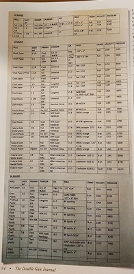

Ross Sefried & Hodgdon Ballistic Labs, DGJ Summer 2021. Ten 16g loads that will work just fine.
Thanks for the reminder, I had sort of forgotten that article contained 16 g articles. Definitely miss DGJ
