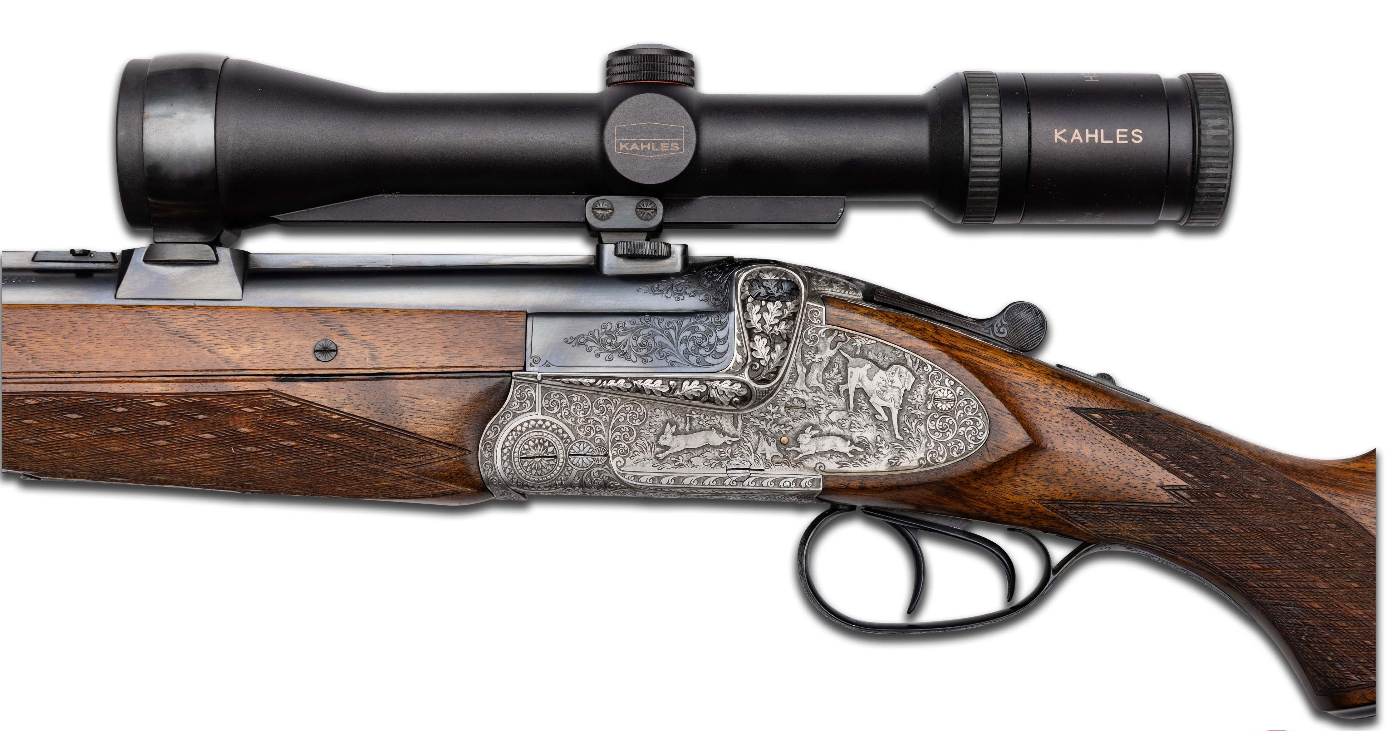

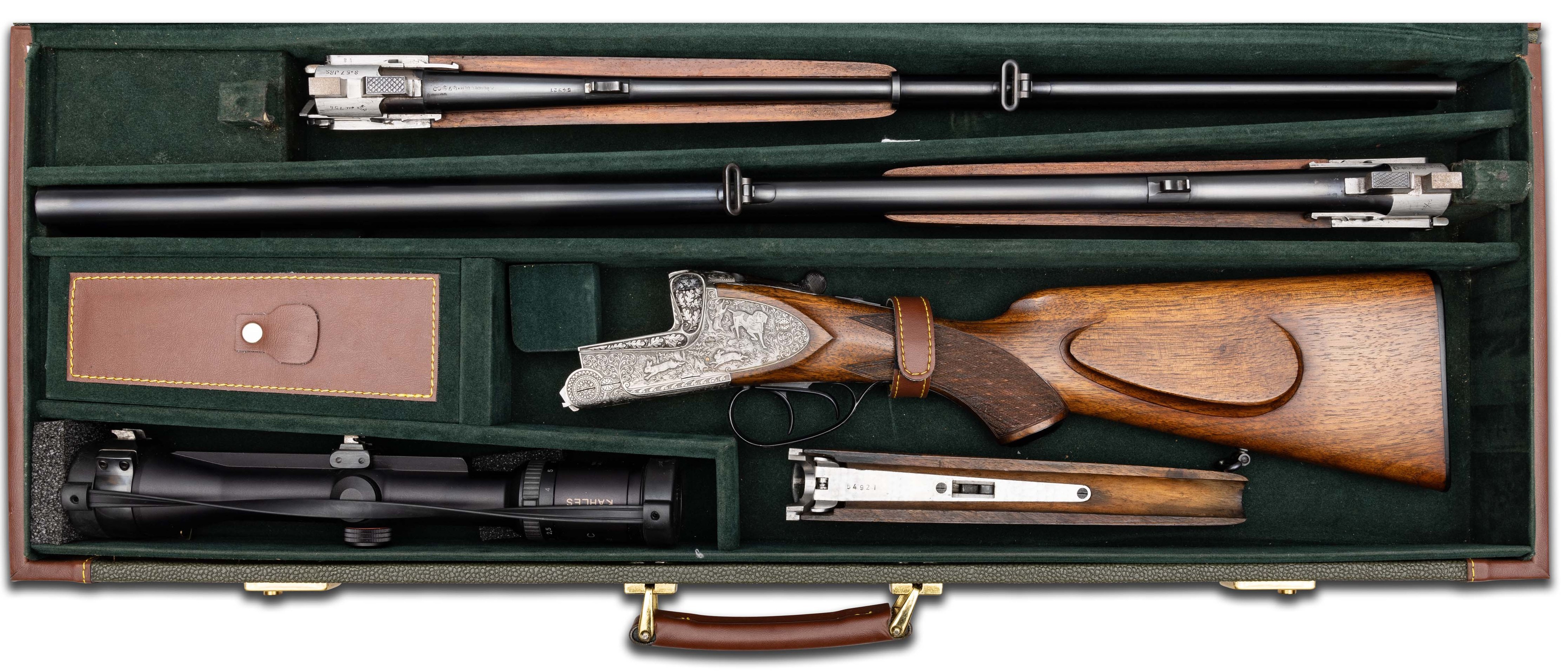

Just acquired HIGH GRADE 1954 SIMSON TWO BARREL RIFLE & SHOTGUN CASED SET 12 GAUGE/8x57 JRS W/ KAHLES SCOPE
Auction titled:
Manufactured in 1954. Shotgun barrel is 29.5" "Gspzial Lauftshal" steel blued with 2.75" chambers and full and extra full chokes. Raised solid matted rib with single bead front sight. Merkel style three piece forearm and ejectors. 24.25" blued shotgun over rifle barrel with raised matted rib and rifle sights, fitted with claw mounted Kahles Helia 1.5-6x42 scope
How can I tell if this is a sidelock? Other comments appreciated.

I would say a modified Anson & Deeley Body Action. Just not enough pins.
Simson was nationalized by this point was a part of the conglomerate.

Blue encircled are the A&D Screws.
Purple encircled is the signal indicator / loaded indicator / cocking indicator - signal pin
Yellow encircled is the sideplate/false plate retaining screw.
Red encircled is the crosspin bolt that holds the 2 sideplate in battery.
