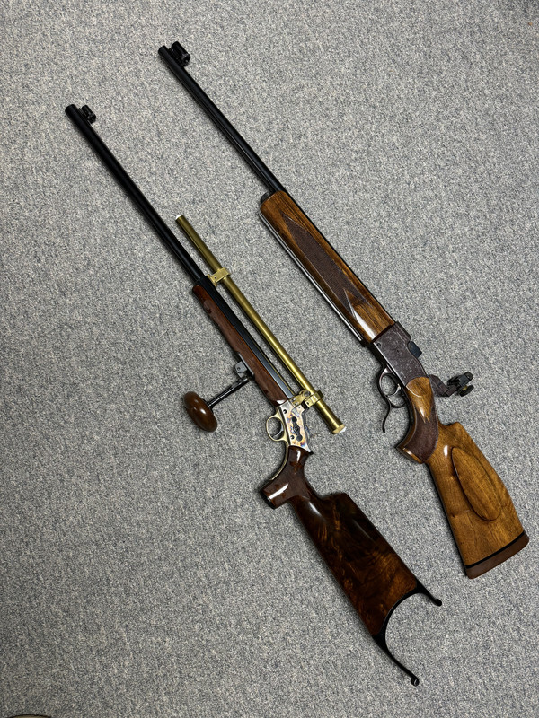

An acquaintance is going into a nursing home and wants to dispose of his two .22s. . The top one looks like a Haenel falling block. I'm confused as to what the rolling block action at the bottom is. Any ideas?

Roller looks like a model 7 Remington
If original, it is worth some money.

It looks like a #7, but isn't. It has a brass trigger guard, and several other features tell me it's likely an Italian action used to make up something to look like a #7. It has no milled cut for the tang sight on the top of the grip frame. Also a bit off on the stock shaping. Prongs too long for a #7 also.
Still would be a fun gun to own and shoot, even as a copy of the original.

I cannot tell if that is brass or just glare on the trigger guard, but I agree it seems not quite right for a real #7. Could be a home made version. It seems a little long or somehow too big. Might be a home brew approximation. I've seen a few, and it has been a very long time, since I have seen and handled and original.

It’s not a #7, like Vall said. Barrel, looks to heavy, and wood are not correct. No rear frame sight. Upper tang is not shaped correctly, to flat. And, it does not have the correct extractor, no screw top front on the left side. Don’t know what the guard is. Serial number would be another indication. Could also be a converted original RB pistol, which could be the reason for the misshaped top tang since a pistol would need rebending.
I have an original in 25-25 with the pronged butt plate.
Not a bad looking gun though, be a fun shooter for someone.
Bob
Actually the more I look at this gun the nicer it looks. It appears to be nicely done.

We certainly don't need a metallurgical analysis to know that trigger guard is brass, and not steel. I did see a resemblance to a rolling block pistol frame, but I try to avoid wild-assed guessing. Nice looking gun though.
