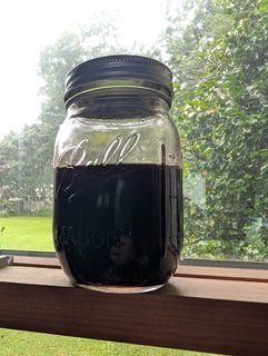

Not long after my last post here, I made up a batch of red oil consisting of 12 oz of raw linseed oil (Viking brand) and 1.5 teaspoons of food-grade alkanet powder. The mixture been in a jam jar in the window of my shop for just over 6 months, and I have shaken it occasionally to resuspend the powder in solution. It doesn't take long for a relatively thick sludge layer to form on the bottom of the jar, and the color of the oil went dark red fairly quickly as well.
Last night, I decanted the red oil into an separate container, straining it with a paint filter. The resulting oil seemed to be almost entirely free of powder, but not perfectly clear. To increase the purity, I then rigged up a mason jar with a coffee filter and repeated the filtering process.
The result, as far as I can tell, is an extremely dark red oil with minimal residual powder.
My conclusions:
1. With careful decanting and filtration, a red oil can be made without fear of contaminating the oil with significant solids
2. Alkanet powder yields a very dark red oil, and a much shorter dwell time would almost certainly have been fine.
3. Along those same lines, I would use less of the powder in subsequent red oil mixtures. 1.5 tsp to 12 oz seemed to be excessive.
Unfiltered:
[Linked Image from i.ibb.co]
Carefully decanting through a paint filter:
The sludge left over after decanting:
Not much alkanet powder in the filter (not fine enough?):
Coffee Filter on a Mason Jar:
The final product:
After 24 hours or so, almost no powder has settled to the bottom:
Jim

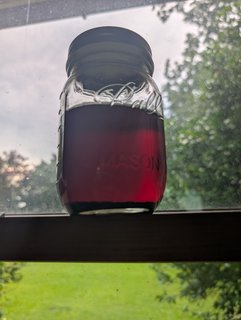

I'm doing a followup experiment: 1/2 tsp of alkanet powder in 9 oz of raw linseed oil (I intended to do 8 oz but overserved myself). I am thinking of 24-72 hours total of steeping before decant and filter. I'll probably assess each day and decant as soon as it looks like the powder has fallen out of solution. I'll then compare the two oils for color on a paper towel just to see how much is gained by a long steeping process vs. the quick and hopefully not too dirty. Will report back.
Jim

The new red oil is at 24 hours.
The powder settled and the oil above appeared clear and fairly nice red.
Since its storming and overcast today, I decided to shake the mixture up and stick the jar in the microwave for a minute (low power microwave-- really only got it warm).
The powder resuspends and makes for a very dark looking concoction. I suspect I could stop the steeping tomorrow and have a very nice, useable oil. :

Day 3:
With the light shining just right, you can see through it. Not quite as dark red as I am hoping for, but still seems a little redder than yesterday:
[Linked Image from i.postimg.cc] [Linked Image from i.postimg.cc]
Once again, microwaved for 1 minute to warm it then stuck it back in the window for one last day. Planning to filter tomorrow.

A-root in BLO, Daly's sealer with A-root, still working on the top coat.

Steve, I’ve used alkanet/blo mix and Chambers for years now. Just so I understand you correctly, after alkanet/blo you are sealing with Daly’s and now top coating with Chambers?
Bob
Posts: 7,395
Likes: 713
SKB Offline
Posts: 7,395
Likes: 713
Hi Bob,
I have never used chambers.
I used Alkanet root and BLO first, then alkanet root and Daly's sealer which was rubbed in with rotten stone, last few coats just the sealer/root combo foregoing the rotten stone and wiped off as much as possible before it dries. I had never finished a stock just like this before but have done it very similarly, not using as much sealer and mostly using Daly's teak oil finish. The sealer seems to have more solids in it than the finish does. I have not decided 100% on my top coat but I'm, leaning towards CCL, I just started using it and like it quite a bit but am not 100% sure how compatible it will be with the Daly's.
Steve
Firearms imports, consignments
Joined: Feb 2010
Posts: 81
Joined: Feb 2010
Posts: 81
Steve, sorry, apparently I got confused with who was using what when reading this thread.
So when doing the Daly’s rottenstone combo, you are filling the grain?
Also, I thought CCL was getting tough to get now days, or have I been misinformed?
Thanks
Bob
Posts: 7,395
Likes: 713
SKB Offline
Posts: 7,395
Likes: 713
Yes, the rottenstone slurry fills the grain. Daly's dry's very hard, be sure not to let it set up in your inletting.
Things are changing, most everything is more difficult and costly to import in the last 6 months, I have bought from DGJ on Ebay and imported it from the UK before the end of the Di Minis exception, not sure about how hard it is to import now. It is certainly going to cost you more.
