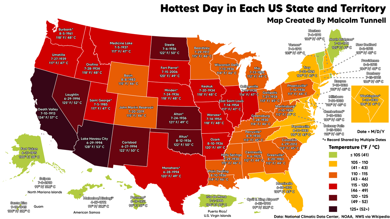

Hey, looky here! The hottest day on record for Iowa was 91 years ago... Older Democrats may need to use their bifocals to see the numbers. And they will also need to remove their blindfolds. But that will never happen.
