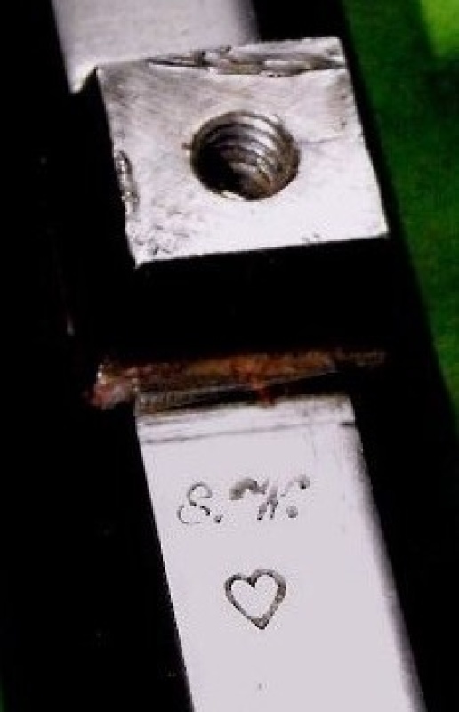

Looks like the tube was sourced or made @ Hänel or by Helmuthhauser - Hellmuthhäuser/Helmuthhäuser
The only German mechanic that used the Heart stamp was Emil Eckoldt.

Hello Raimey,
thanks for the info ... any idea what the SW stamp above the heart means?

Have you put a Glass on it? Is it really >>SW<<??? >>Suhler Waffenkunst<< is about the only guess I can muster on that.
But I think it is a Script E.W. ; maybe for Emil Weiß?? There are other possibilities like E. Werner; Ernst Wolf, Ewald Wolf; Ewald Wahl & a few others. Really need to narrow the mechanic to either Suhl or Zella - Mehlis, & I think the latter.

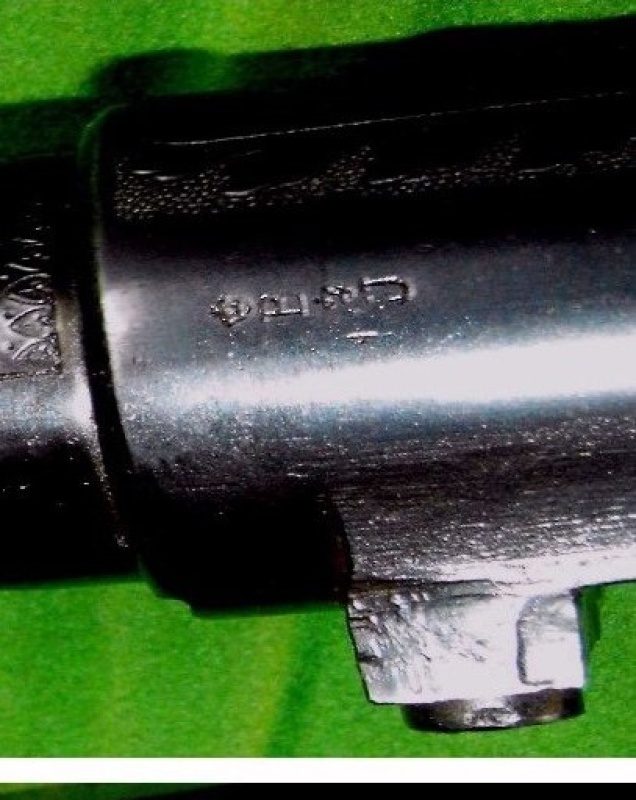

Too, I would like to see a better foto of these marks? Is it a poorly stamped >>B<< or a>>P<<?? If indeed >>B<< then it was proofed in the final state.

Take Ernst Stoll, he advertised as a Rifle Barrel Compagnie but up till say WWI, he either sold or sourced barrels from Hänel. So, considering marks & the retailer, it could be considered an all Suhl weapon where only Suhl mechanics were sourced.
